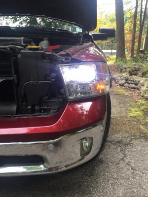

FF6BDACA-83C6-442E-AE43-0ACB8127A81D.jpeg B443E965-D6BB-433C-9ACA-3EFAA6D2DE4E.jpeg
2016 Ram 1500 Bighorn CC 4*4. I hate the headlights (quad i think). They are not very bright and don’t seem to project far ahead. Without going for all these conversion options I’ve been reading on here which confuses me (opt, morimoto, hd conversions etc), I was wondering if anything like this is A.good and B. easy plug in replacement. This is what I was looking at and wonder if not these, is there anything that will work as a plug in swap that is an improvement over stock
https://www.1sale.com/products/novs...-10000lm-6000k-xenon-white-2-year-warranty-4/
I just changed my low beam to VLED’s micro in July. Big upgrade vs stock OE bulbs. Plug & play install. I have 5K pure white color and it puts out 3500lm per bulb. I did add the ‘Ram cancellers’ to prevent flickering and bulb out warnings, but many people told me I did not need them (bulb only). Everything fit behind threaded dust cover.
25% off sale going on this weekend! Been using VLED’s for years and never any issues. Buying the high beam. I’m going 6K white w/ tint of blue for the high beams. 4500lm per bulb.
