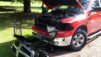

One last bit... This is the first vehicle ever that takes this much effort just to change a headlight...
Here's what it took last Tuesday:
Yup. Crazy design. YouTube videos show the guy removing lights without taking out grill and using a long extension to get bottom light housing bolt. Good luck with that because even with the grill off, that bolt was a pain and took forever to remove on both.

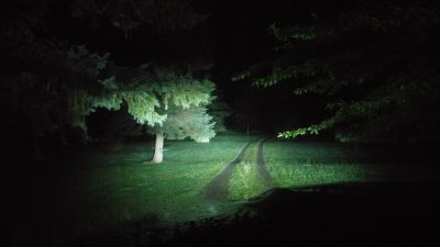

Final update (since this morning was the first chance I got to actually do this comparison...)
Halogen pix taken on Sept. 10th , LED pix taken this morning, looking down my 500' driveway, front tires on the edge of the asphalt pad in front of the house (though it appears there's a shift to the right).
Lo-Beam: Halogen (L), LED (R)
Hi-Beam: Halogen (L), LED (R)

Is it just the camera or does you LED's wash out the color that much?
Easy if you use a magnetic socket and one 12" extension
Both. The camera is a crappy LG G3 phone camera, but the higher blue tint of the LEDs will wash out the red colors a bit.
