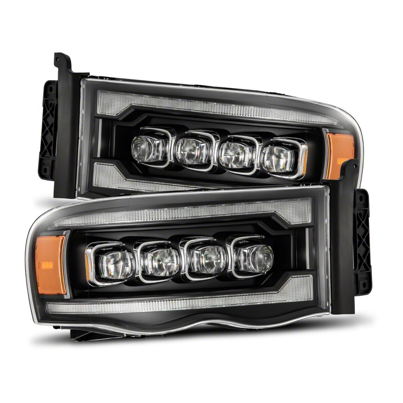

Are these any good? Will they just plug in and work if I remove the HID kit?

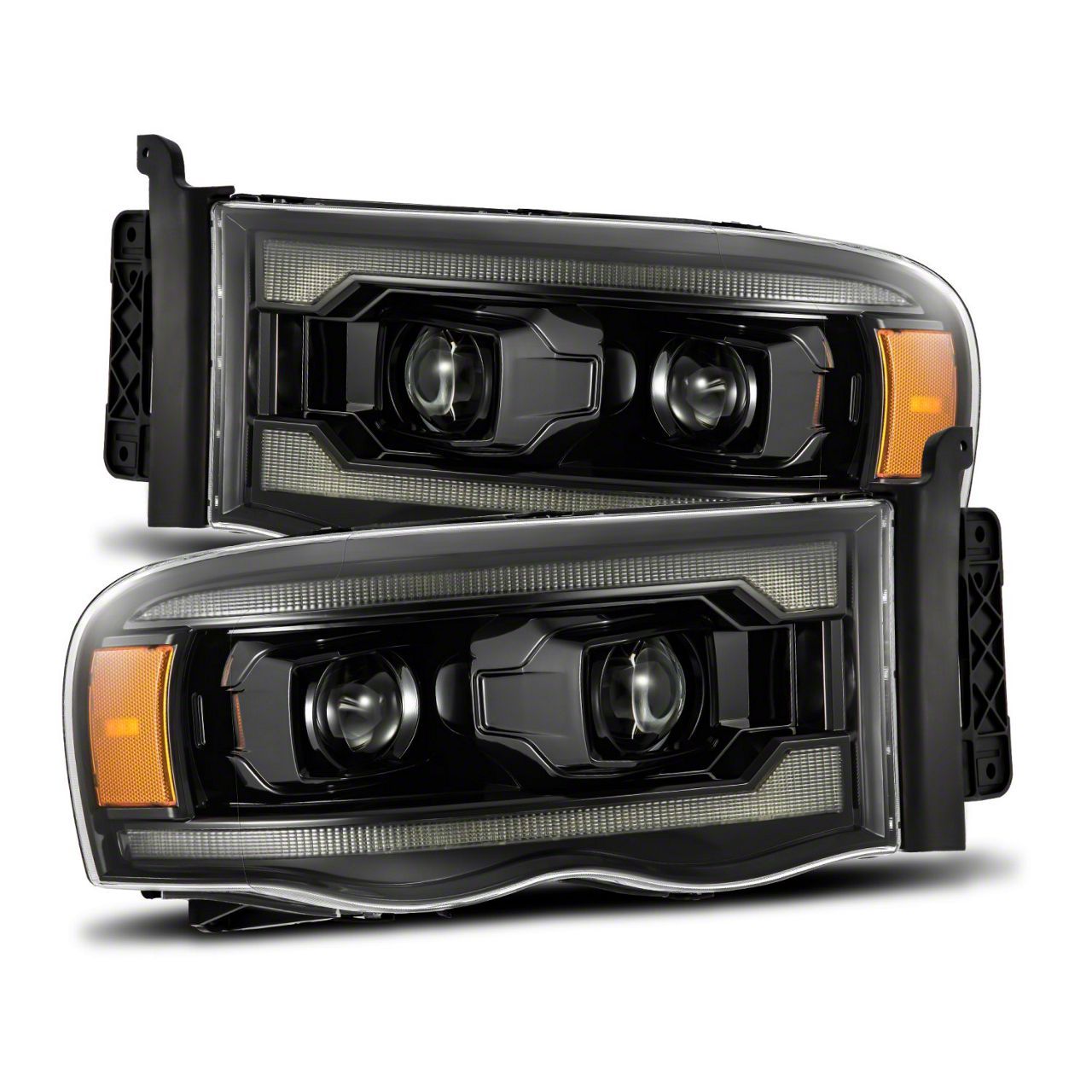

What about something cheaper like this?

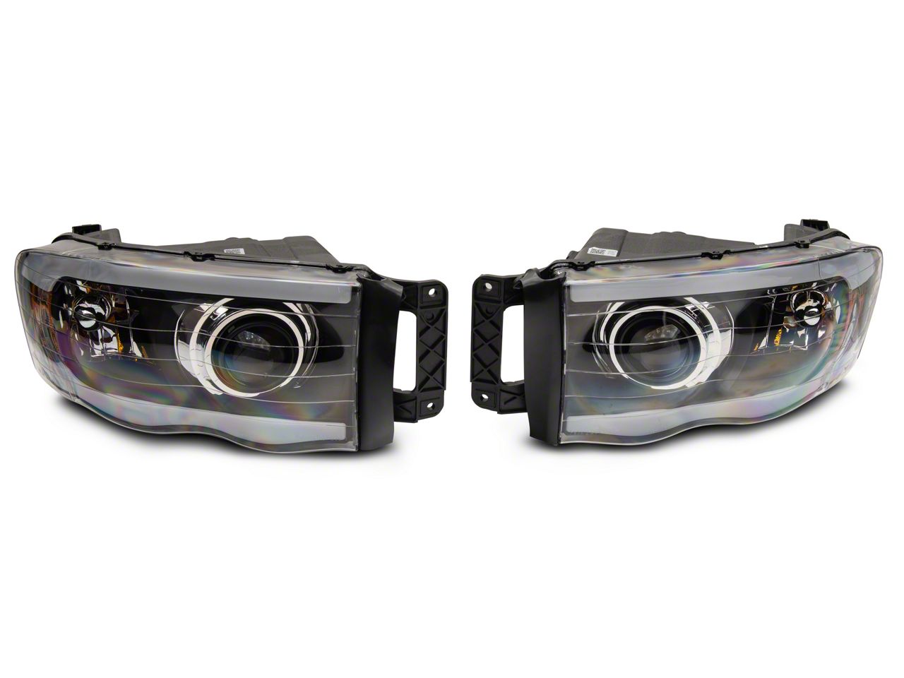

What about something allot cheaper like these?

Many members are happy with Alpharex headlights, their Nova and Luxx series are all LEDs where as the Pro series use halogen. You can put LED bulbs in the Pro series but people report the Luxx series has better output.

Nova or Luxx, the cheaper lights you end up having to buy another hid kit to make them bright and then issues can crop up from the poor quality projectors.

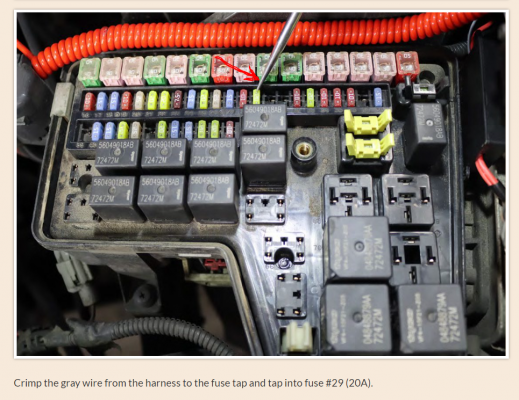

Ok I got these installed, but for some reason when I hookup the running light wire the running lights never shut off. I even disconnected the gray wire tap from the fuse box and there is no difference. Actually the fuse box wire tap that these lights come with does not plug in according to the directions as the wire coming off of it bottoms out on the relays behind it.

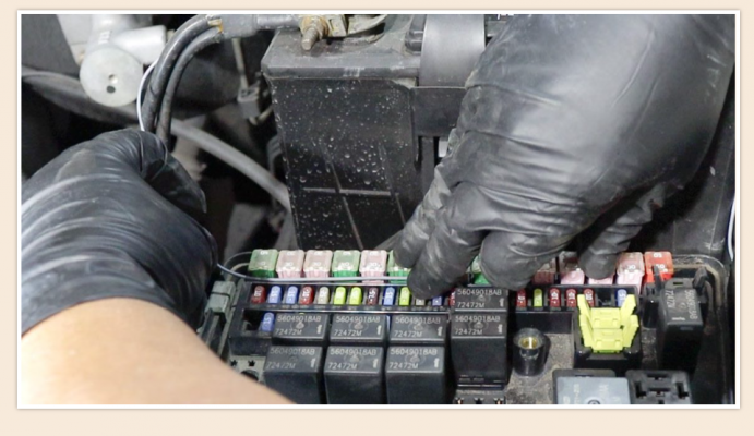

This picture shows the relay or taller fuse that prevents me from installing the tap.
The next pitcture in the directions convieniently shows the guys finger in front of where the tap is supposed to go.

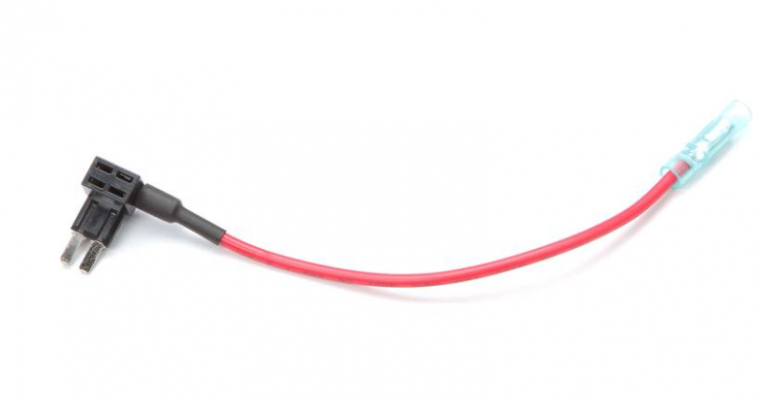

The fuse tap basically looks like this, and as you can see the wire sticks out the side and hit the relay or the fuse since they stick up above the mini fuses:
Anyone have any tips on installing these correctly? Should I just leave the running light wire disconnected and the tap undone and deal with the issues?
