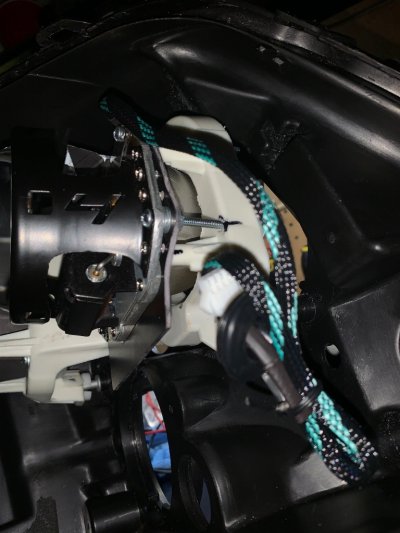

Lmao I did the same thing. Got the AlphaRex lights, installed the Innovited hid H7 kit, ran it for almost 2 weeks then sent it back because I decided to crack open the AlphaRex lights.
Let me tell you, the AlphaRex lights are expert level 100 retrofit. Nothing is like normal retrofits and even me with around 100 headlights under my belt, struggled for a few weeks making custom fabrication brackets for them. I tried 5-6 different styles, methods, ways to mount them and none of them ever mounted them in the correct spot for the housing and front bezel, or they were not sturdy and were going to bounce on bumps.
I finally found a method and had to make custom fab brackets combined with jb weld once I dialed them in. I can still adjust them horizontally with the stock AlphaRex adjuster. They are so badass and amazing. Also used AlfaOBD so no annoying harnesses everywhere.
I had them on my truck for about 2 months but I used the VViViD Hex+ Smoked Hexagonal Headlight Tint on the DRL lenses and that combined with the weak white/amber of the profile prism RGB strips, the DRL output and turn signal was super weak. So I took them off and reopened them and installed Profile Sequential Strips for the DRLS and removed the VViViD vinyl tint. Just resealed then and putting them back in tomorrow.

Do you have any pictures or can you offer any tips on the bracket you made? I’m not interested in changing anything at all except the low beam projectors. Don’t need new high beams, don’t need fancy LEDs for the turn signals or drl, not smoking anything, I just want better projectors for the low beam. I’ve never opened a set of headlights, but I’m quite crafty and very much mechanically inclined.

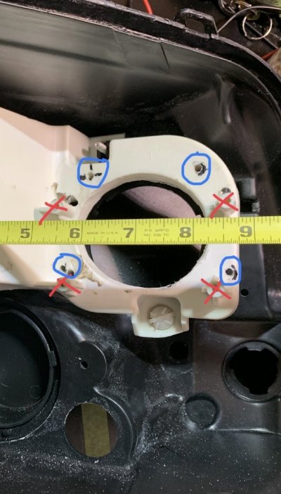

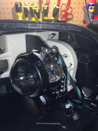

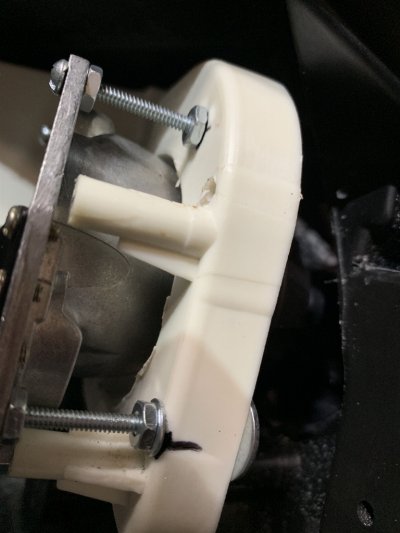

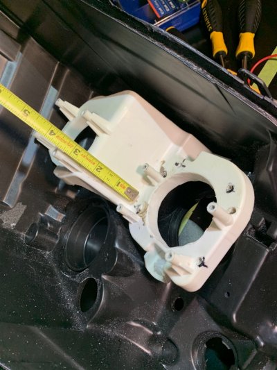

Yes I do. The hardest part was the low beam projector. Getting it mounted level both Horizontally and Vertically since there is not the usual bulb hole or any sort of spot to mount the projector. The AlphaRex use a 4 “post” mounting design, but the D2S does not come close to mounting to it. I have no idea if the H1 8.0 or any other projector might have the bolt holes lineup better.
Here are some pics:
Here are some pics:
Wow, that’s a lot of mess to get it to work. Is that white bracket something you 3D printed?
bigred90gt
Jul 25, 2017
906
671
No that is part of the original AlphaRex internals.
Gotcha. I might try to mess with them. I’m pretty happy with my TYC projectors, but I like the look of the alpharex. If their H7 projectors weren’t wonky, they’d be great. They’re rotated 45 degrees (the groove for the tab on the bulbs sits about 1:30-2:00 looking at the back of it). When you put HOD in them, the return wire is not at 6:00 and it throws off the hotspot. I tried modifying the bulb base and shimming it to fix it, but could never get it right so I just went back to the TYC.

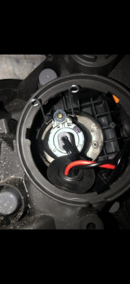

That’s really weird. Mine were perfectly straight and the output was really good for the cheap projectors they have in them. I was shocked at how nice it was compared to crappy eBay “projector” headlights. I only opened them up and swapped the D2S in there because I wanted a true projector in there and a bunch of RGB stuff and I love the look of them. But if I didn’t do that, I’d have been ok with the output of them from the factory.
The part colored black in the picture is the groove where the tab sits. The screw is at 12:00 (where the tab is sitting). To get the bulb to seat properly, I had to rotate it to get the tab into the groove, and the hotspot was jacked. I tried cutting a new tab in it so it would sit in the groove and fully seat, but no matter what I did with shins and manipulating the metal base, I could not get the hotspots right.
the hotspots and output was perfect with the LED bulbs, but I was out driving the beam once I got to 45-50- mph.
