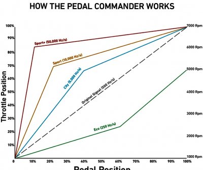

So I definitely know our trucks have a little bit of pedal lag. I know all the different options that can "get rid of it" and everything. But I've thought about buying a PC and here's my thoughts and I want to know who agrees with me, and if you disagree, with me why do you think I'm wrong?
I'm my profession (network engineer) your connection is only as fast as the slowest link. I believe that carries over to a lot of different things and I believe this is one of them.
I could be wrong in this and correct me of I am but the PCM reads the throttle position sensor and tells the throttle body to open up to whatever percentage.
Now if this is true then you will always be tied to how fast can the pcm read the sensor. How fast can it tell the TB to open up and then how fast can the truck responds to the TB opening up.
I'm my opinion plugging a device into the pedal itself can't make every other device react faster unless every other device is programmed or changed to read faster.
Am I correct in my thought? Am I wrong? If I'm wrong can you explain to me why? It would help me convince myself to get a Pedal Commander lol

Im with you. PC cant predict when you are going to press that pedal.
My car has a "sporty" throttle and it kinda sucks when you have 300 horses. If PC works, i am not sure if i want 400 horses to an open differential.

I've done a bit of tuning on GM engines that are Drive By Wire, and generally the way these work is to override what the PCM sees and then "throttles" the opening rate of the TB. Depending on the PCM it can limit how fast/how much the TB opens and opening rate. For example, even if you MASH the pedal to the floor the PCM can limit how fast the TB opens (some GM ls engines limit the opening rate, so even if you floor it, the TB "slowly" opens vs. the old cable pull on a carb which could open quickly). This limits how fast the engine revs up and puts out power. Most TB are fully capable of going very quickly to 100%, so to the OP, the limiting factor isn't the TB opening rate, but rather the PCM holding it back--usually as pointed out for emissions, warranty and sometimes safety (imagine 400+ hp hitting the entire drivetrain quickly, spinning the tires, leaving smoke and black marks --- that does sound fun though). These devices changes the signals to the PCM to make it open the TB quicker/faster. I would expect with a tune, you can rewrite the PCM calibration settings to get rid of this, but if you don't want to tune, I'd say these devices would be a fun choice, as they are easily removable.

Hope this helps. The only thing is on the original signal line it doesnt show the annoying default pedal delay. It was even worse in 4WD Lo. Just ask my wife. I would curse it everytime. The pedal commander straightened that all out. I was hesitant to spend that much on some gizmo but sure glad I did

Petal commander is a HACK. Plain and simple. It remaps petal input to make it appear that suddenly the truck is much more responsive.
What it is doing is taking say light throttle input and sending high throttle input to the ECU. The truck thinks your hamming on the accelerator and responds accordingly.
...and your slowest link is not always your bottleneck.
That's correct with the 9 Drive. It remaps what petal position relates to what throttle position.
Petal Commander remaps what petal position relates to what throttle position, and increases how often the position is reported.
