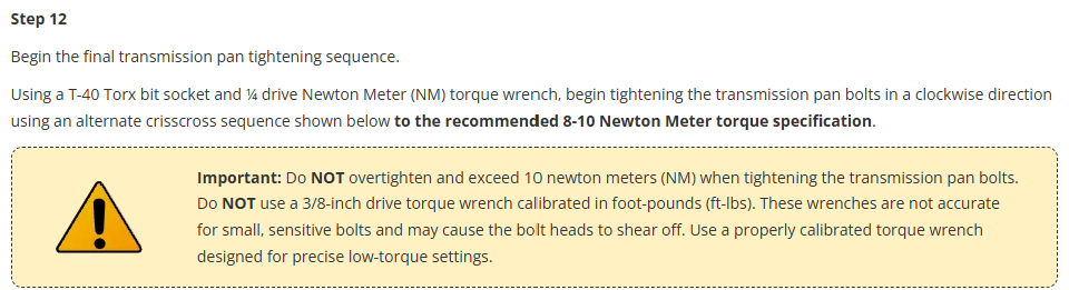

I know why they broke, I overtorqued them. Youtube video told me 20 nm(14.74 ft lbs, 177 in lbs)
It supposed to be 12 nm(9 ft lbs, 105 in lbs)
I may need a new pan, when I hold a ruler to the pan, where the holes are they are raised up so that there is a gap between the holes, unless this is normal.
8-10 is what blauparts' guide says...I ASSUME they got their info from ZF.
He has a Chrysler 65rfe 6 speed in a 2012. No ZF information needed.
