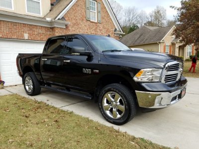

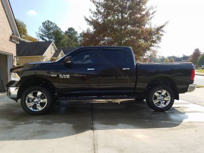

I have the maxtrac 4.5" lift and can currently fit 37s but only 12.50 wide with stock wheels. I think the first thing you should do is measure the front end compared to the rear end. Maxtrac 7" lift is designed for trucks with 2.5" of rake in order to level the truck out with that lift. I wanted the 7", but my truck only had 2" of rake so I was stuck with the 4.5" lift. There was no way I was going to end up with the front higher than the rear. Its a great lift, but I have not heard anything about Rough Country 2wd lifts. You could jack up the front end or whole side of your truck to see what 6" vs 7" of lift would look like.

And I'm sure the RC is a good kit, but I think we have a Maxtrac rep on this site. To me, that means a lot too...that's Customer Service.
PS LOVE my Maxtrac 4.5/3"

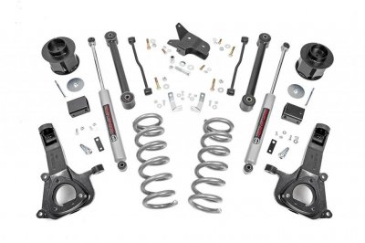

I'm getting the 6" RC put on mine on Monday. There isn't a huge diff in quality between the two, so I decided an extra inch wasn't worth $400

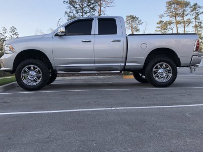

I just installed the 6'' rough country lift kit on my 2016 ram 1500 2wd on tire size 35x11.50x20's.

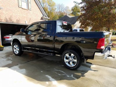

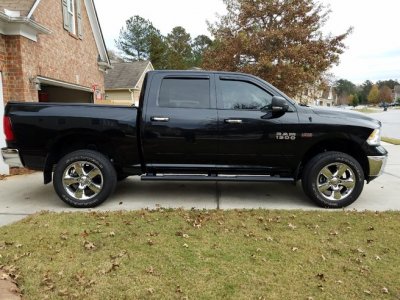

I really wanted the 7", but i have kids that are too small to get up. I have Maxtrax 4.5/3 with 1.5 rear wheel spacer (the front will stick out about 1" out because of the spindle swap). Stock wheels/tires. Mine sit pretty level. I can up go higher later on. To acheive 7" lift. All i need is 1.5 rear spacer and 2" front spacer or coil spring from Maxtrac.
