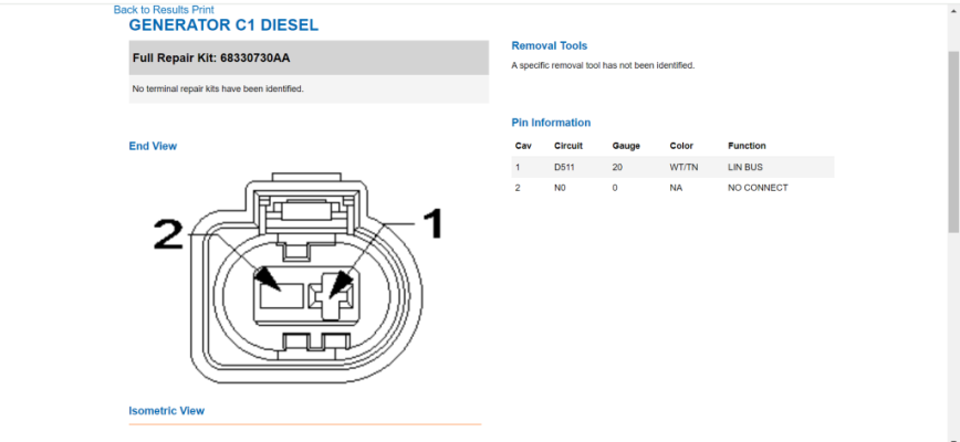

ok if that's what it dose I don't know how to use it correctly, do you have any advice or directions on using it? this is d511 where I am starting how do I use this to find the next connector or splice the wire go's through.

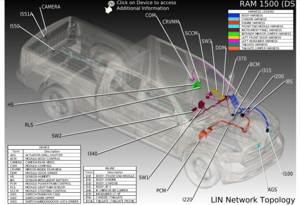

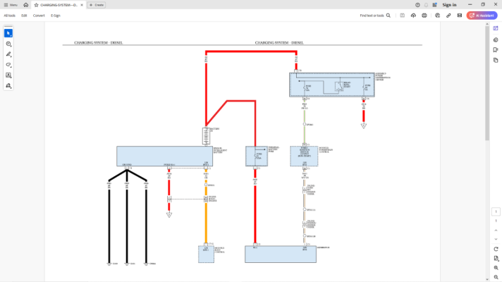

May not have what you need but see Attached , this may help...

that plus the other link used together is pretty helpful. but some of it is still like talking swahili to me.. like the connector labeled INLINE-BODY/FRONT END MODULE is there a way to show a location of that in a pic or 3d image?
like i found this for spd511a but i cant find any of the connectors or the spd511b..

either my computer wasn't loading that third pic or your sneeky and edited that in..
can i ask what you found that on? its almost exactly what i need but the 3.0 ecodisaster is wired a little different.

it looks like you would call the connector circled in green l200 on Mpgrimm2 3d image. what connector would you say the one in blue is called?

My apology, for some odd reason, that doesn't appear to be as useful for your search.
I'm not sure which connector you identified on Mpgrimm2's connector layout diagram, but I have found that path on the Mopar connector link site. This will show the connector appearance and associated pin outs.
The Service Manual urges against cramming meter leads into these large connectors to avoid damaging them and creating intermittent connectivity. I would just use caution and avoid applying too much force.
The attachments below start at the Actuator- Grill Shutter and up towards the Power Train Module.
