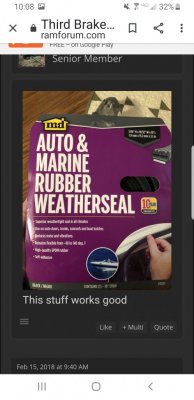

Yep, get rid of the crappy 3rd brake light seal and replace it. I used weather stripping from home depot,(dont remember the thickness) over 1.5 years ago and no issues since....knocks on wood

I don't thing halloween decorations or turf builder will help TOO much, that's what came up in that link:D
Whatever you use Add some RTV (silicone caulk) to it, problem solved.
Try the new link, F home depot.
