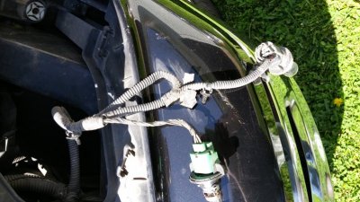

Bought my 09 laramie about a week back. I noticed the driver side headlamp was a dual and the passenger was a quad. I have bought a quad headlamp to replace the dual that was put in there. My question is where to buy the connector I need.
Did you buy brand new oem quads? I just did and it should already have bulbs attached to a harness that plugs right into the h13 connector (vehicle side).

yeah that's a little strange. Hope you didn't buy it from a dealer like that. I would have made them fix it if they didn't disclose it.
Anyway the connectors are the same for the quad and the dual. The only thing that is different is the light bulb harness which the quad should have come with
Edit: looking at your picture, looks like someone spliced up your harness for the dual headlight? Id be flipping out lol.
I would look for a junked ram and cut part of the harness and splice it back on.
Edit 2: after staring at your picture is the plug directly on the bulb? The green one
