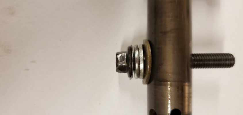

Here's a couple photos of what I found. Looks like I'll have 9 exta mounting pads when I'm done.

Lets have a pic of this broken mounting pad you're talking about.If it's the aluminium pad that the rocker shaft bolts to on the head,you might be looking at a new head,as they're pretty critical

I'm pretty sure I am using the wrong term for the broken part. It it the square piece that sits on top of the shaft and the bolt goes thru it. I also noticd in my pic that the wear pattern is overlapped by the washers, meaning there was either contact with the rocker, and or a geometry alignment with that rocker.
The pad on the rocker arm shafts should never be removed, although there seems to be a 'natural' tendency for some folks to pry them off.
This is the first time I've even heard of the mounting bolts breaking like that! I suspect they were bottomed out and jammed, which could happen if the mounting pad wasn't there. If they were over torqued I would expect the threads to pull out of the head.
By the way, they are three-step torqued: tighten to 7 pounds, then to 23 pounds, then back off 1/2 turn, and retorque to 23 pounds.
