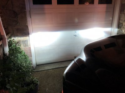

pics below of my setup with GTR HIDs:

here ya go, these were Putco Nitro Lux 6000k LEDs before I switched to HIDs.
My factory reflector LEDs on the 2019 are awesome, I’d say even better than the setup you see in these pics and the HID pics (those were on my 17 Sport projectors.)
Also agree that HIDs are the way to go in projectors.

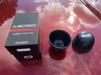

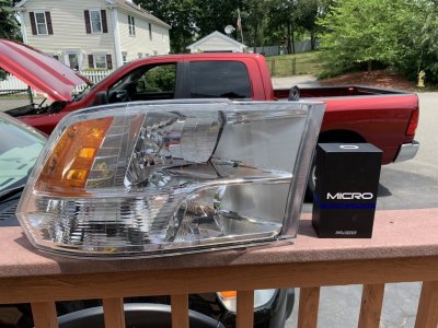

I have 5K LED’s in my low beams and 6K in my high. 5K is pure white (best IMO) and 6K has a slight tint of blue. Mine are quad style / open reflector headlights so I had to use the ‘regular’ bulb in lows but have the ‘extreme’ in my high’s (see pic’s below). The low beam fit behind the OEM dust cover no problem, but I had to order 85mm covers from Amazon for the high beam LED bulb.
With your truck, the projector style you can use micro extreme and the results will be similar to a 35W HID. Click the link and you can read up on the details yourself. 30 day money back guarantee if you do not like them + free return shipping. *Confirm for correct bulb*
https://www.vleds.com/shop-application/application-low-beam/9012-hir2.html
1st pick is micro evolution 5K LED and 2nd micro extreme 6K (ideal for projector or high beam reflector only).

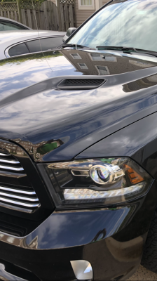

It’s pretty easy to spot. Projectors are tiny little round bulbs and lenses that almost look like a mini spotlight and precisely focus the light beam. Reflectors are just a big lens/housing with shiny mirrors where the light bounces off from.
Anyways, all late model (past 2011 I believe) Sport Rams have the projectors so I’m almost 100% sure you have the projectors.
Here is a pic of a projector on my last Ram, a 2017 Sport
