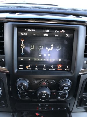

Thanks for quick response. I posted a question in the HVAC problem thread as well. Here's what I have going (read below).
I noticed the the last two mornings something odd going on. FYI it is around -5*F out last few mornings this occurs.
Before I shut the truck off for the night when I get home, I make sure the truck is in auto climate control set at 74*F. In the morning I remote start the truck (Drone Mobile). After it's running 10 min (when I get in the truck roughly as I'm getting ready for work prior 10 min), I notice the climate control shows it's heating the floor only. I put my hand up by the defrost and there's slight amount of residual air flow. That's about it. So the window starts to fog up a bit. I manually hit the combo defrost/floor blend and it does as it should, but now it's not in auto. This has happened both mornings to work and when leaving work with about same temps outside. I was wondering if there is a setting to change in Alpha OBD for what defaults to for winter or summer? I also wondered about putting my 2015 HVAC module back in? After installing the ATC harness on Wednesday I didn't notice this behavior, but It was pretty cold out lol when installing everything. Any suggestions?
FYI - On my 2019 Jeep Cherokee it's always is defrost or a blend of defrost/floor (forget which) when started when cold outside.
When you have the truck on Auto it shouldn't show you were the air is flowing. It should just show an (A) on the climate icon and if you go into the climate screen they should all be grayed out until you take it off Auto similar to your Jeep. Did your truck come with the 8.4 radio and if so why did you replace your HVAC module? There is no setting we have found to change the parameters that control the air flow. I know for sure my truck is on defrost/floor when I remote start my truck on cold mornings. It may have been on full defrost a few times but to be honest I've never really gone back in and checked to see. I am definitely going to check it now just to see how it acts. The one thing I have noticed is the climate control does not really start blowing until the engine temperature reaches a point to actually do some good instead of just blowing cold air. I have noticed with this mod the ATC works but I doubt it works as good as a factory dual zone ATC set up because we are running our trucks on ATC when the HVAC system wasn't really designed for it. All that being said if your truck never goes on any type of Defrost on ATC then I think there is definitely something strange going on. I am assuming it acts the same if you start the truck with a key when you have it on ATC on a cold morning?

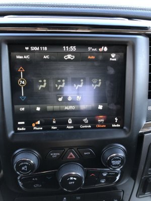

I have to do some running around at lunchtime for work today. I will go freeze my butt LOL and start it manually and see what it does.
I’m pretty sure when I set it to auto the floor heat icon appears (lit) on the 8.4 4C screen. I switched out HVAC module to 2018 model because of the radio and the heater controls not working correctly.

@load97 I did activate the humidity sensor in my Ram under LIN and Misc - Humidity Sensor Present. However, as @Ricks Ram has stated some have had issues. While I did not have any issues doing so, I observed no change in activating it through Alfa. As stated, the BCM automatically picks the sensor up and resolves the AC compressor not shutting off issue.
As far as the auto setting. I have tested this in my truck and noticed there is a blend of floor and defrost in cold conditions. When the truck starts to warm, it appears as though it switches to mostly floor. Just yesterday here in VA after the rains and it warmed up, mine (set at 70) actually switched from heat at floor to a very slight cool at the vent.
Ok. When it's actually on Auto it shouldn't show where the air flow is going. It should all be grayed out in the climate screen and have an (A) in the heater control soft key and it should definitely go into defrost mode when needed. I am assuming your truck is a 15 and you installed a 2018 UAQ or UAS radio? Sorry if you had already stated that somewhere but I can't see certain things with Taptalk. I actually installed the 2018 UAQ radio in my truck for a brief time but did not like it and took it back out and put my RA4 back in. Unfortunately it was during the summer and I didn't leave it in long enough to see it if it had any issues with ATC. I did not like the way it couldn't communicate certain things to the EVIC and the truck and just didn't care for the themes or the over all look of it. That being said STecoD Actually has a 2015 Eco diesel and he has the 2018 UAQ radio and he has the ATC mod. He lives around the corner from me. I will shoot him a text and ask him to check and see how to his acts since he's basically running the same setup as you are. I'm pretty sure he would have noticed by now if his defrost wasn't working but I'll double check.

Thanks. I’ll report back my finding. You are correct with my vehicle and radio swap (done through infotainment.com)

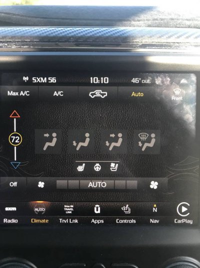

Ok he sent me a picture of his screen and it acts the same as the RA4. You cannot see the air flow setting or fan speed when it's on Auto. He said he hasn't noticed it not going to defrost but since his truck is the Eco diesel when he gets in the truck it he just turns it to full defrost because it takes so long to warm up anyway.4ee21691518e711b743f2eafcce059a7.jpg

Thanks for all the help guys and so quickly! I’m quite embarrassed. I had it backwards how the button works. I was thinking when the button auto button red in upper right corner meant auto was turned off. I completely blanked out on that. My auto dimming mirror has always been a white icon and I’m guessing that was never on either lol. I really haven’t driven the truck all that much since getting it, so I never really paid enough attention.
