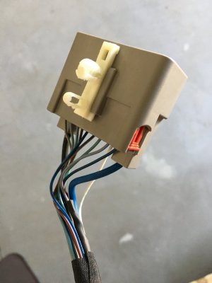

Once you have the old box out with the fan, now would be a good time to install a cabin air filter, you need to pull the wiring off the old box and install on the new plenum box( you can also clean the condenser if it's dirty). You have to add one wire to pin 6 of the grey plug and then tap into the DB/PK wire that goes to pin 12 on the grey plug to make the connections for the new blend motor.

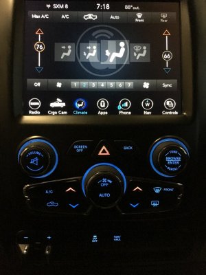

You will now have to pin the HVAC module plug in pin 3 to pin 6 of the grey plug. Get the A/C recharged. Use Alfa to set to Dual zone ATC. Enjoy playing with it.

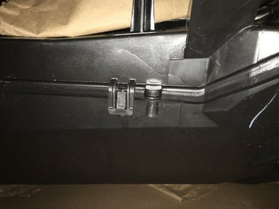

After parting the fan assembly from the main box I reinspected the replacement HVAC box and discovered a crack at the front and forward mounting location.192BE63F-25D1-4A95-BCA6-8603FD67D2F7.jpegI had to resolve this issue because I wasn’t about to install this box. It took time but here is what I was able do. I compared the original box to the damaged boxes I had received and found that the part numbers were the same on the main box. I visually confirmed there were no differences aside the manufacturers label. So I split the replacement box and removed the dual deflector panels for the dual zone option and then split and removed the single zone on the original(undamaged) box and installed the dual zone panels. Attached the fan assembly and wire harness and readied for reinstallation the next day.
Note. May have a viable option if you can order the dual zone panels and split the box to replace the single zone panels. You still have to remove the box and fan assembly and then split the box just enough to install the panels.

Sunday, HVAC box installation continues. I had to wire the connectors as describe by @STecoD and connect the actuator.E1CB738D-F115-4450-92F8-6E00087AD8CB.jpegB42567D9-9DC7-4D24-93B4-F9F7E62F5932.jpeg It would have been better if I had drained the coolant rather than pinch the hoses it was just a matter of clean up.

So with this Mod. Do you still only use your one temp sensor on the drivers side knee panel? Cause how does it actually determine the temp on the passenger side if there is no temp sensor on the passenger side or am I missing something?
Ricks Ram
May 1, 2015
4,411
3,416
Yes it only uses one interior temp sensor. This is the way all the Dual Zone units I have worked on operate. There is also another temp sensor prong in the box itself but the Dual Zone unit and the Single Zone unit use the same one.
