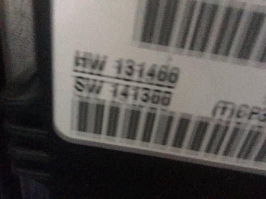

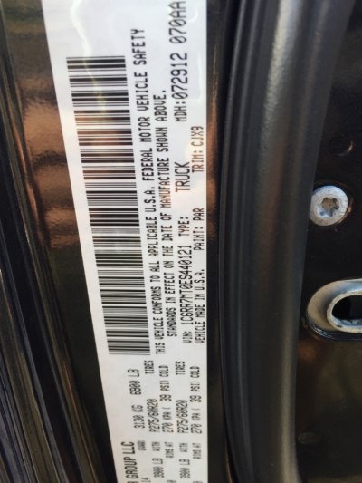

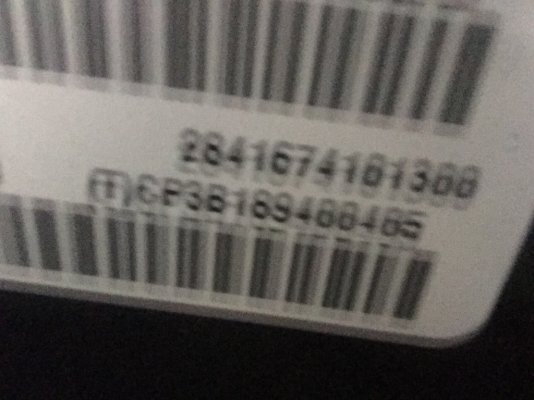

12sportmc
Oct 21, 2016
797
356
NC
Adding Heated/Ventelated seats and Heated Wheel to Express/Tradesman
See other pic
WilliamS
May 3, 2016
2,638
1,195
Tampa FL
68217263AA thats what you have 00 R/T? You have heated and cooled working?
That part number googled comes back to a 2014 SLT/Bighorn with (luxury package) heated seats and steering wheel package.
I wonder how hard it is to get out, Ill steal that thing in a heartbeat. I think this is from the 2015 Sport I tried the steering wheel out on. Didnt work in my truck, wonder if I swap this module over itll work?
12sportmc
Oct 21, 2016
797
356
NC
Need the top right corner, it will start with a (P) next to the letters CSWM
Haha. Realized that after I posted it. I'll see if I can get him to send me another pic
