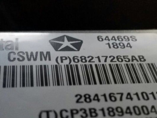

68217263AA thats what you have 00 R/T? You have heated and cooled working?
That part number googled comes back to a 2014 SLT/Bighorn with (luxury package) heated seats and steering wheel package.
I wonder how hard it is to get out, Ill steal that thing in a heartbeat. I think this is from the 2015 Sport I tried the steering wheel out on. Didnt work in my truck, wonder if I swap this module over itll work?
No. I have heat only. My seats are from a 2015 Big Horn. I'm trying to gather a list to figure out how many different variants of modules are out there.
So far we have:
68217263xx:
2014 - Front heat, steering wheel, no vent or rear heat.
2015 - Front heat, steering wheel, no vent or rear heat.
We need years and options for any of the other numbers we've gathered.

From a 14 Sport with heated/vented fronts and no rear heat

Ok it appears that mine is 68217265AO
2016 ram 1500 sport crew cab. Heated and ventilated front seats nothing in rear

Ok, this is excellent.
68217263xx:
2014 & 2015 - Front heat, steering wheel, no vent or rear heat.
68217265xx:
2014,2015,2016 - Front heat & vent, steering wheel, no rear heat.
This is looking like it isn't a year thing, but rather an option thing. Before I go back and look, do you both have the same number DeereGuy and WilliamS? Both are from rear heat trucks, right? Do we know year of donor?

Vin of my Donor, 1C6RR7NT5ES163142
Although till either Deere or I get a *265 module we do not know if this is the solution.

Cross referencing in the Chrysler books shows the part numbers coming up as 5026618AF for a Laramie but it just says heated with memory nothing about vented. Gonna keep searching but if you use those numerics you can actually pull modules up in the catalogs

Thats for the memory module not the heated/cooled etc module.

Correct. But it pulls up the actual seat module diagram when u search that PN. My post was a little vague.
