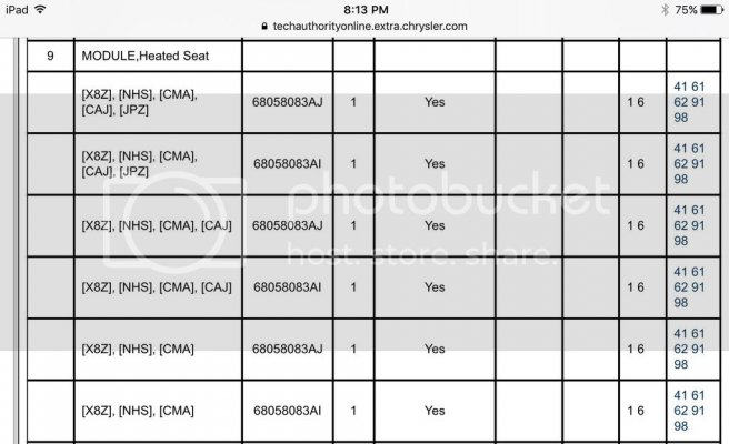

I took the VIN from the sport specified earlier and put it into tech authority and this is what I get back.
I cross referenced these sales code against a list of sales codes that I have.
NHS-heated steering wheel
CMA-heated front seats
CAJ-ventilated front seats
JPZ- heats seated second row
X8Z - wasn't in my list
I also put VINS in for Laramie trucks with and without a center console and I got back the same part number for both: 68217268AD. Which happens to be the same module I have in my seats. I really expected the VIN with the jumpseat to have a different module since it is my understanding that the jumpseat Laramies do not have heated rear seats.
That's interesting. That would seem to imply that for 2014 at least, there's one part number regardless of options. So, the question becomes why is yours different?
If you get a chance, can you check two more VINs?
1C6RR7LT3FS527255 - 2015 with heated seats only
1C6RR7NT1DS559468 - 2013 with everything
I have the first set and the second are on the way. This might help us reconcile p/n's on the modules with their dealer replacement part.
1C6RR7LT3FS527255- 68217268AD
1C6RR7NT1DS559468-68058083AG
Mine came from a 2016....
This is starting to look more like the part number difference is by year and unrelated to the features. That first one are the seats in my truck that have 68217263AB. According to that, though, they should have the same module as yours. Maybe that's just a newer replacement for it.
This doesn't explain why your module is showing an error for not having the rear seats hooked up. If the modules are interchangeable, how does it know it's supposed to have heated rear seats?
