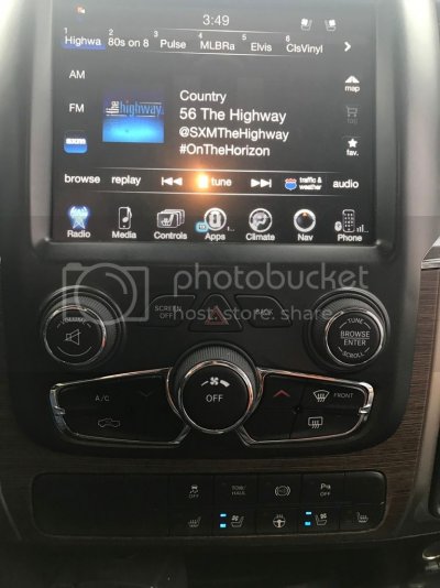

So like most everyone is speculating, I made a change to the BCM using the AE tool. I actually changed the setting in ECU #5 - Memory Settings and set the vented seats option to present. As soon as I did that the vented seats started working. It seems as ECU #3 added the buttons to the screen but ECU #5 actually made the truck know that the vented seats were there. I also set the rear seats to not present using the same ECU but the diagnostic codes for the rear seats persist. I am not sure why but everything works now.
