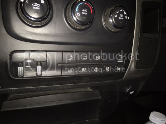

Adding Heated/Ventelated seats and Heated Wheel to Express/Tradesman
Is the dash switch available just heated seats no heated wheel
No. Heated seats and wheel always come together. There's no trucks that just have one or the other.

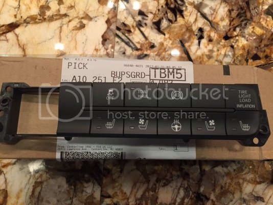

Switch panel for diesel truck

What about passenger seat are most manual heated or power heated I'm looking for just passenger seat I've got heated driver seat

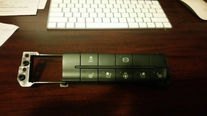

Switch panel I recived, sadly not what I needed. But here is the part number and options that came with it for you diesel guys
Sent from my SM-N910V using Tapatalk
What options are you missing?

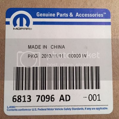

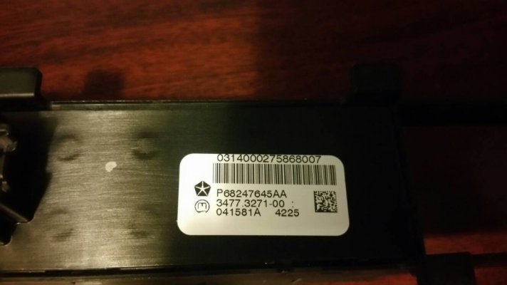

Here's the correct part number for my truck, I told Benny the options I needed to have on this switch and he gave me the number to order :happy107:
I'm working on the harness install this weekend and hope to at least have heated seats to start with.
