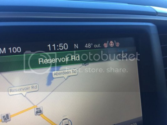

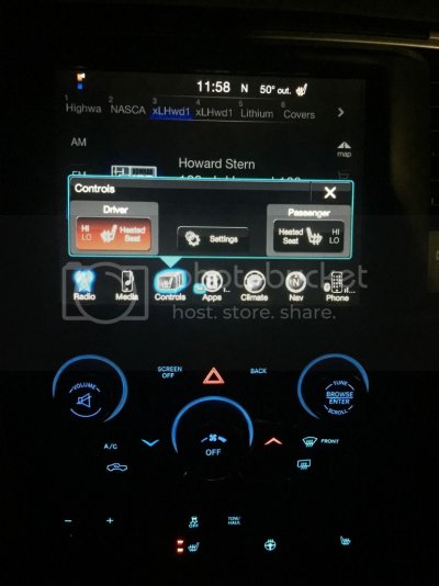

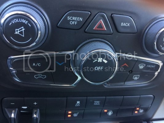

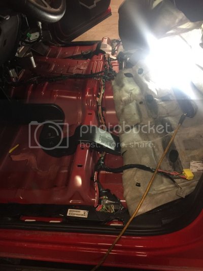

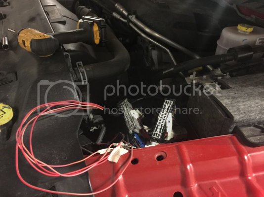

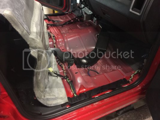

Got my heated seats all wired up and working! Thanks to all and a special shout out to Deere and Rick. I went right to the pcm with the wiring. I have the heated wheel wiring installed, I just need to install the clock spring and wheel. A while back I had the dealer turn on the code for the dealer added heated seats. I had the icons on my screen, but they didn't function. Now the hard and soft keys work for the heat. Hope to get the wheel and clock spring installed in the next week or so. I'll report back on that. My truck is a 2015 2500 tradesman. I pulled back the carpet and zip tied or taped the wires to the existing harness.
