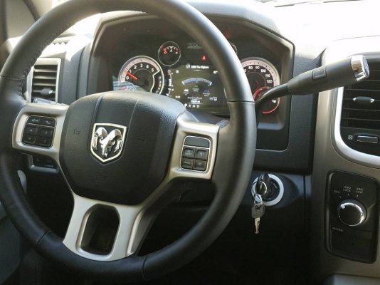

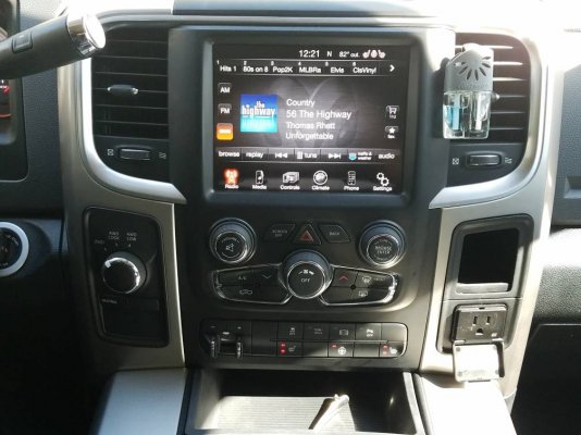

Well while we have been talking and posting the job is done!! Everything works! I hope i dont run into any issues but so far everything works. Big thanks to everyone! Any questions to anyone wanting to upgrade i will be more than happy to help.
Sent from my SAMSUNG-SM-G930A using Tapatalk
jrome
Mar 5, 2016
69
6
hemi
Heres some pics391578fce03e83d46146215bbb2e80c7.jpgacec87f41722d316f41dd3f4a342e54e.jpg
