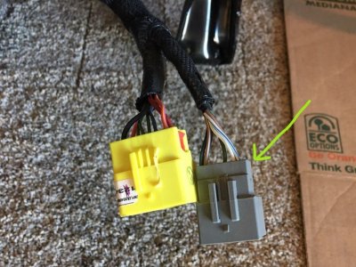

Okay, got my seats installed last night and ran a temp power wire (RED) to adjust the seat until I get the harness. I am a little confused on the wiring under the driver seat. My tradesman seat had Two grey plugs and a gray cell phone charger looking connection under the seat that were all just daisy chained together with the other ends going under the carpet to the center console (assuming to the center console and passenger seat). My new seat had a yellow plug and a grey plug but after plugging everything back in I am not sure what gets plugged into the Grey plug that was attached to the seat. The Tradesman seat only had one yellow plug to begin with attached on the underside where these two plugs are at under the driver seat. :help:
The grey plug will be included with the harness you get from M2 Mods. Your Tradesman will not come with the wiring harness that plugs into the driver side seat. The gray plug has 5 wires that go from it to the passenger seat two wires that go to the heated steering wheel connection under your column and two more wires that hook up to your CAN connection under the driver side kick panel. This it's similar to what your truck will look like after you install the M2 mods harness. The gray plug will be included with it.431e046aecab6cbcb1f9fa235d8d407a.jpg

Awesome thanks Rick! That makes sense if that connector is included in the harness. I was looking at it and was confused because I did not know that connector was part of the harness (assumed it was supposed to be in the truck and just pin it out) thanks again.
When I originally converted my truck I did it a little bit differently then the factory way to get power to my seats. There were connectors that were not present in my PCM( power distribution center, also known as a,fuse box) so I just ran a relay from the battery. When M2 mods came out with her harness I felt as much better option so I bought one. This is a picture of the actual harness I received. You can see the gray plug in it. I have worked with both of these guys and I can assure you when you get your harness you will be blown away by how well it's made and the attention to detail. Every single wire will be marked where it goes you just need to pay attention to the schematics and instructions and make sure you plug in everything in the correct pin. aa5d0da8be1f7911d0acf1b2f3f15771.jpg
