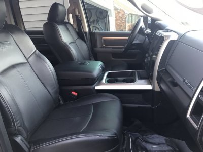

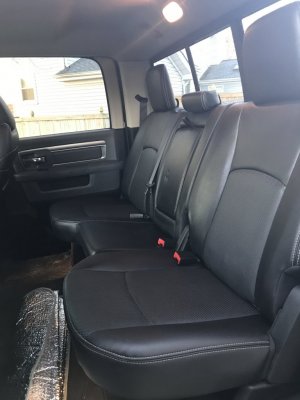

Just want to thank everyone who helped me out with advice and answers to make this install happen (especially Nathan and Rick). Got my Laramie seats installed in my 2016 2500 Big Horn that had no heated options. Now have heated/cooled fronts, heated wheel and heated rears with all memory options working.

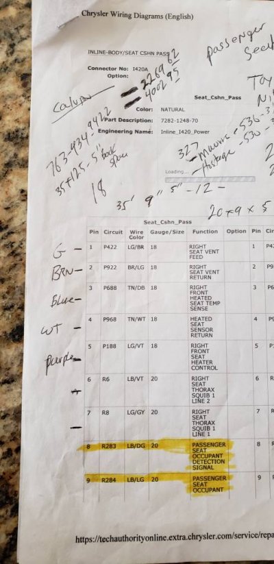

Sorry got sidetracked and forgot to send you the pics of the Schematics. Do you still need them?

No problem @Ramit2016 Looks good. Are you going to sell me that big horn glove box?
No problem, thanks Rick. I think I've got most of it figured out but if you have them handy I'll take.
Pretty sure I've isolated what I need and pretty sure I can make it work. I think the easiest and cleanest method for me is to get the female yellow Can Bus connector and make my own harness. That way I don't need to cut anything. I'm going to try and reach out to DeerGuy again and see if he can help me locate the 14 pin yellow connector, unless anyone on here has 1 floating around.

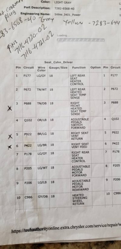

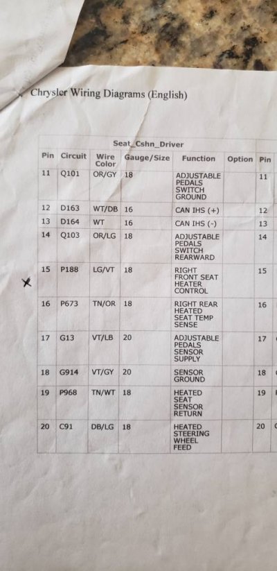

This is the drivers side 14 pin yellow connector635dce45f33069b94a09907ff9d42f41.jpga888861bc6d8ad154fb5afc2333cc9a9.jpg

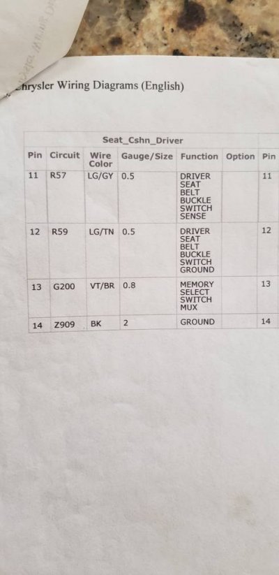

Driver's side 20 pin gray connector 7231adb4e37f5faa9498cfe96ca3b5db.jpge5ac9d91169ed142dc98d22288a04c29.jpg

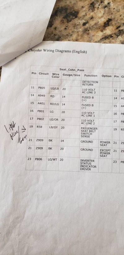

Passenger's side 24 pin connector.....Remember 2012 trucks run on a completely different system that the 13 to 18 trucks. Even if you are able to figure out a way to rout all the wiring the chances of the seat modules communicating with your truck enough to have any of the heating or vented features work are slim to none from everything we have learned. 31f483229b442357acee0c9ab1361643.jpg637d58ceb0e11e2d38d662647da51e4e.jpg

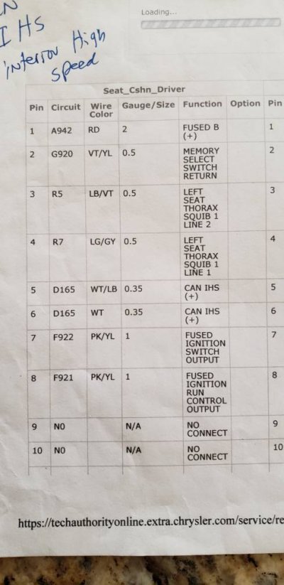

Thanks Rick! Appreciate all the info. I get it with the heated/vented feature. My truck doesn't have all the computer/digital stuff like '13-'18. That said, I'm pretty confident I can wire that feature separately using the typical rocker switch that aftermarket heaters use. I'll update as I can.
Shot DeereGuy a PM so hoping he can help me with the female 14 pin, if not, I'm searching the old interwebs.
Any chance you're able to confirm pins 3 & 4 (left seat thorax squib line 1 & 2) in the 14 pin connector is the airbag? I've pulled the seat cover and foam bag and that appears to be what it is but just checking.

Yes those are the wires for the seat airbags. Before I installed my Laramie seats in my truck and we had not figured out the wiring and we could not add the codes I was able to get the ventilation fans to run while I was doing some testing by connecting them to a 12 V source but I cannot remember where I tapped into the connector because it was so long ago. I do remember I completely unplugged the seat module because I did not want to damage it just in case we ever figured it out and low and behold we did lol! The problem with the factory seat heaters is they run on a 3 wire system and most aftermarkets run on a two wire system. The factory heaters are designed to run with a seat temp sensor,seat sensor return and seat heater control. It would almost be better to disassemble the seats and install after market seat heaters and hook them up to a toggle switch. The only problem with that is that on the Laramie seats the actual seat heater pads are incorporated into the ventilation system as one unit. I will also say the the factory Laramie seat heaters work well but the do go up very far on the seat back at all. A quality set of after market seat heaters that you could actually mount up a little higher would probably work better than stock anyway but of course you would lose your ventillation capabilities.
