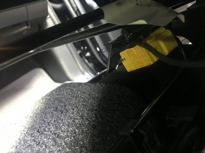

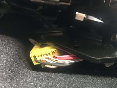

Thanks!
it did come with a 8.4 radio, not sure UAS or UAQ :(
There’re 2 connectors under driver side seat, but the grey one connects nothing. Yellow one connect to motors; a yellow connector under passenger side, only 2 wires, route to back but I think it to safe socket.
shall I go with some programmer like alfaobd or something to make changes?
Like activate ATC?

Ah Finally someone with a 19 HD. :). No one has attempted a seat swap in a 5th gen that I’m aware of. I’ve been looking at the wiring diagrams for the 19 HDs lately and they have changed some of the wiring including that grey connector that you sent the picture of. Most of the remainder of the wiring seems to be the same as the 4th gens. I’m trying to source that connector to be able to offer 5th gen harnesses. There is also significant differences between the seat wiring of 1500 and HDs at the 5th gen level.

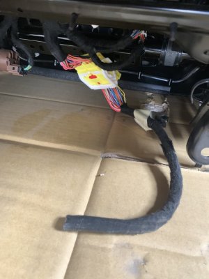

Nice to see I’m not the only one working on a solve for the 5th gen! I have a 19 2500 tradesman, and I just bought a full set of sport leather seats to put in. I was lucky to have received the truck side pigtail still connected to the seat plug (cut). I verified that getting the power functions to work requires only the red power wire and black ground wires to be connected, but the rest of the wiring looks like a headache. As you mentioned, the plugs are very different between the tradesman and the sport/Laramie trim. Let me know if you have any thoughts on getting this to work like factory. Until I am able to get a factory harness, I will probably re-pin the Laramie harness with the wires from the tradesman pigtail.

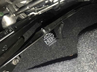

Thanks!
Like activate ATC?
Your connector looks the same as mine in my tradesman, which is different from the Laramie seats I have sitting in my garage
So the laramie seats that you have are out of a 19 1500 and your truck is the 2500. I don't think you will be able to replace the harness. They seem to be wired completely differently between the models now. I haven't had a chance to really dig into the wiring differences or module information to see if the seats can be switched between the models.

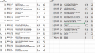

Here are the pinouts for the different models. The seat modules are also different part numbers between 1500 and the HDs.
Nick45l
Sep 24, 2019
Utica NY
Thank you for that, I’ll take a look at it and let you know what I come up with.

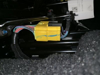

Well, I found out why the wiring is different. It seems that the entire seat is different including the wiring and the mounting locations between the 1500 and the HD trucks. When I looked closer, the 1500’s actually have a slightly larger cab and different body lines - the HD’s have the cab size and body lines of the 10-18 trucks. That being said, I have a complete set of bucket seats and rear seats from a 1500 sport that I don’t have a use for anymore . Lessons learned I guess. I’m sure it could be done with some seat bracket fabrication, but that’s more than I want to tackle right now.
That sucks! Unfortunately it's's all part of the learning process. We went through similar issues with the 4th gen trucks before we got it all figured out. The wiring was a little different in the trucks themselves but the seats and the seat harnesses were the same. Hopefully you got a good deal on them and are able to recoup your money and get the correct ones for your truck. I feel if the alfa developer adds the 5th gen trucks to the tool so the correct codes can be enabled that this upgrade will be very doable. Good luck and keep us posted.
