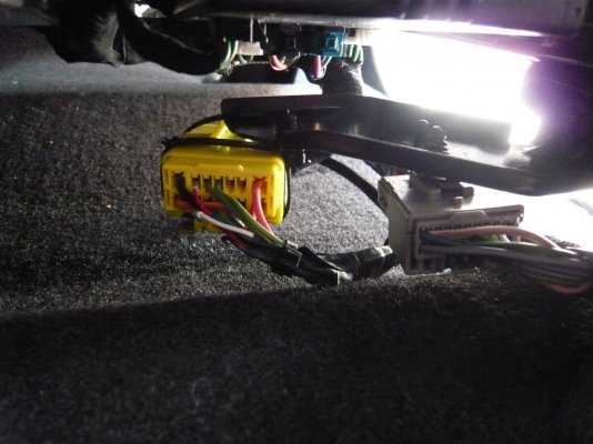

Rick as you remember i changed out my 2015 ram sport seats to Laramie full leather seats to get AC seats. With your brilliance we got everything to work . Had all the wiring if u remember except seat belt on donor seats.
How difficult to see if i can get the memory function on seats to work. 2015 ram sport. Simple as adding functions with OBD or dreaming lol
Glad to see you got it working. It's strange how my truck and the others we have done had the wiring from the door module to the door harness and your truck didn't. In any case it's good to know for others that may run into the same situation in the future. I really like the memory function. I don't use the tilt in reverse setting as much because I don't always want them to tilt. Now I just adjust down whatever mirror I may need when I park and as soon as I touch my door handle to get back in the truck it automatically goes back to my memory settings.

Anyone? Lol
Pixel.....if you go back a page you will read some of my posts on getting the memory function to work. In fact its one of my posts that Ricks Ram quotes. The first step would be to see if you have the necessary wiring. Under your driver's seat is a yellow connector. You need pins #2, #5, #6 and #13 to be populated with wires to see if you have some of the wiring in place. I pasted a pic of my yellow connector under the driver's seat. For a point of reference so you can determine if you have the necessary wiring, when looking at my pic the top far left slot with the BLACK wire is #14 ( directly below #14 is #7 and to the right of #14 is #13. We could go from there once you find this out............

Thanks. That answers my question. Think i have all but definitely not number #13 so atleast i know where to start. Thank u

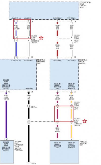

FYI, this is the section that @mjf6175 was missing ... Plus inside the doors (regular cab) . . . Most have the section in the doors.e1fd2e8b2534c29255f98aa12facfded.jpg

Pixel.....looking at your photo it looks like you are also missing a wire in pin#2. You can see an open slot that is between the blue wire and the red wire ( which is in pin slot #1 ) in your photo. That would be pin slot #2 which makes some sense since you are also missing #13. The wires that are suppose to be in slots 13 and 2 go to the In Line Door Connector. Look at the wire diagram posted by M.Grimm in his post above, the schematic shows #13 and #2 in the section he highlighted on the lower right of the schematic pic.

Sorry I didn't respond earlier. For some reason my notifications got turned off. I can see that all the questions have been answered. It's really pretty simple and M2mods can make you the jumper harness if you want. Remember you will also need to enable the memory codes.
