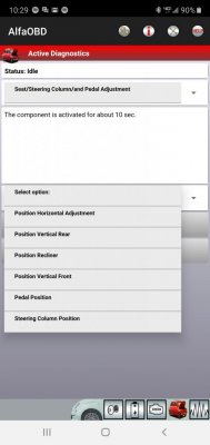

Thought I would post here as well. I installed the front heated/vented seats tonight. I plugged the pass side in,bolted up and the power worked fine for adjustments.
I plugged in and bolted down the driver seat and the only thing that works in the lumbar support function. I had power driver seat previously, so I'm not sure why that function stopped working.
I enabled the necessary msm and heated/vented functions in the body computer. I can see the functions on my headunit, but nothing turns on. I've also tried connecting to the msm and hsm (alfaobd and obdlink mx), but it fails everytime.
I dont care about the memory function as much as I do the power functions, and heated/vented functions.
I'm also waiting on my switch panel to show up. Could that be the missing link?

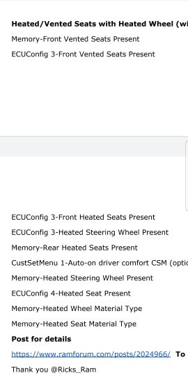

15 Bighorn with donor seats from a 14 laramie.
Your memory won't work until you add the 4 needed wires. Two from the drivers yellow seat connector to the CAN system and two from the drivers yellow seat connector to the drivers side door harness. You will not be able to connect to your memory module unless the wiring is added. It's not necessary if you don't want it. Your power seat functions should work. It has nothing to do with your truck. Your lumbar working shows that the seat has power. You either have a bad switch,bad connection or another issue with the seat itself. As far as your heated/vented seats not working are you sure you enabled all the codes for the seats? I have posted a picture with all the codes that need to be enabled. You should not need to enable the heated wheel if you don't have one. Last question is are you sure the heated seat module and memory modules were not removed from the seat? I have seen it happen in the past when wrecking yards sell seats. I reccomend looking under the drivers seat to make sure both black modules are present and no wires were disconnected.079e7ab77fcdba2670cba5dda2d90981.jpg

I think I've narrowed it down to the msm and hsm. Or at least, that's where I'll start. I can connect to every function with the alfaobd and obdlink except for those 2. Is there a way to test power coming from those units?

Remember you cannot connect to the MSM module because your truck does not have the memory wiring. In other words your truck cannot communicate with it so that's normal. You should be able to connect to the HSM as long as you have both the grey and yellow seat connectors connected and all the seat wiring is in place. The seats with memory have different motors that are wired to relay there information to the MSM module. I have seen in the past when they were changed the seat adjustments will only move in small increments because the MSM module is not picking up the signal from the motor. Not sure if that would happen in all situations but I have seen it happen. A lot of people add the heated seats without the heated wheel and they work fine. I'm not sure if I have heard of anyone adding the heated/vented seats without the heated wheel. I guess it wouldn't hurt to try. Remember by enabling the heated wheel without having one it's going to set DTC codes because your truck will be looking for the wheel it doesn't have. It may also be the fact that you haven't installed the switch panel. Trucks that come with the Aux switches don't have the hard buttons and they work but they are programmed differently. I would install the switch panel to see what happens before you go to far. Also use the alfa tool to check for DTC codes and see what comes up. As far as the seat not adjusting if you have physically looked under the seat to verify all the modules are present and connected and no wiring is disconnected I'm kind of at a loss as to why it's not working.
I'll wait for my switch panel and install that and see what happens. When I traced wiring in to the big bundle, it appears as though all wiring from the truck to the seat goes in to either the HSM or the MSM and if the can bus doesnt know the MSM is there and able to communicate the status, it might explain why the power functions dont work either. Here is a list of options in the MSM that I cant do anything with.
That's all under DRIVER SEAT > MSM POWERNET.
I'll have to add those wires you mention for the memory module and see if that helps, too.
Moreover, I dont see seat lumbar in that driver seat menu anywhere, so that wiring is probably a pass-through. Vs the power functions being controlled by the MSM because of the memory. Since the module stores the location of the seat between memories and exit, it makes sense to use the same module to control power functions in the seat.

What I am about to post pertains to what I found on my 2017 Ram 2500 regular cab when I added heated/vented seats, heated wheel, and memory mirrors.
I first added Laramie seats to my RC, they were heated and ventilated. My RC had the wiring there and was plug and play. I did not add a heated wheel at the same time. I added the heated wheel later. But the heated/ventilated seats worked fine without the heated wheel. Adding the heated wheel later also posed no problems.
The seats I added already had the msm and hsm under the driver's seat. But I did NOT have the 4 wires on the truck side harness that are necessary to have memory. I added those wires later. Again the missing memory wires and having no memory function did not interfere with the heat/ventilation of the seats, they worked as designed.
Hope some of this helps you.....good luck, I am sure you will have it figured out shortly
