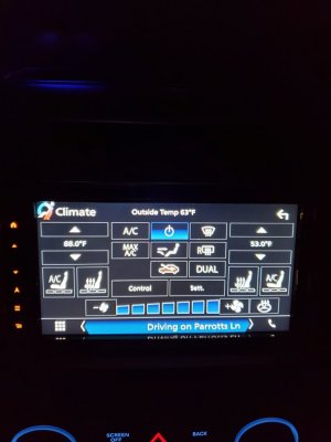

Here's a shot I took of my headunit. Kenwood dnx574s.

You can tell the the BCM did tell the radio the codes were added but there are only two temp settings with the heated and vented seats and not three as shown on the radio so it would seem the radio is not configured correctly. I have seen mixed results with aftermarket decks with certain functions within the truck with the radio communicating with the CAN system. Installing the switch panel is the next logical step to try to see if the heated/vented seats function. When you said the controls were on the screen I assumed you had the factory 8.4. The fact that you have an aftermarket deck could definitely explain why you cannot activate the heat and vent through the radio. The vented seats will not work with any of the factory radios except the RA3 8.4 or the RA4 8.4 radios. Hopefully they will work through your aftermarket unit.

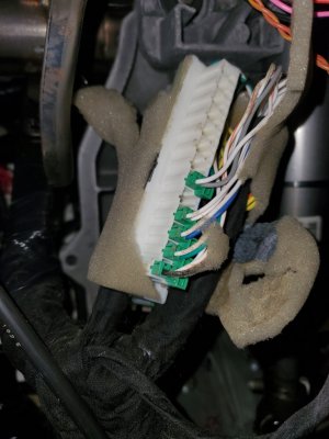

I'm just as confused on the memory wiring. I've pinned 5 and 6 on the yellow plug and from what I found, these is the c4 connector based on the wiring diagrams I've seen.
I'm not sure how much it matters the connectors go in the slots designated by the wiring diagram. I'm also not sure if that is the correct component to be connecting to, but in the almost 80 pages I've gone through, I havent been able to find a solid answer yet.

Joe....I recently did this as well. Wires 5 and 6 go to the Canbus. The canbus connector is on the far left behind the kick panel, the one right behind your parking brake. You have to remove the lower kick pane land you will see a long green connector. You use ANY 2 open ports.

Yes.....this is exactly what I did. Ran 2 wires from the yellow connector under the driver's seat (wires 5 and 6) to the canbus behind the parking brake kick panel. I believe JoeB (posting above) already did this after reading my post and it worked for him too.
