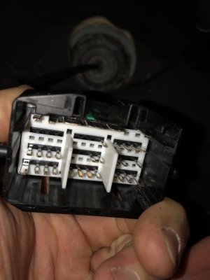

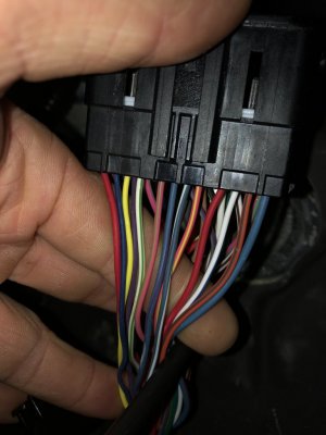

Picture of your connectors?
Sent from my Nexus 6P using Tapatalk
nick87
Jul 21, 2019
BC Canada
ecodiesel
51F8C841-1747-4C85-A5F0-441CA4863E98.jpeg 1841CDE3-6CEE-4E7E-A966-F205E1160425.jpeg
This is all I could get quickly and easily, I’ll take some better ones after work (about 10 hrs from now). The wires that I’ve got my finger behind correspond to the bottom row, as you can see #35 and #40 are both populated.
My one thought is that if I could confirm the wire colours I should be looking for that it would make sense to look at the other half of the connector with all the female pins...... in theory this makes sense to me but I’m a little leary of just plugging things in (I really don’t wanna fry something by accident)
Ricks Ram
Ricks Ram
May 1, 2015
4,411
3,417
View attachment 177804 View attachment 177805
On the schematics I have the correct color wires are
Heated Steering Return GY/LB
Heated Steering Wheel Feed DB/LG.

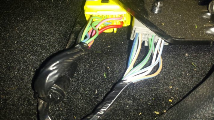

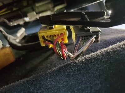

Here's what I have for Driver's Side wiring. Looks like I have everything I need.

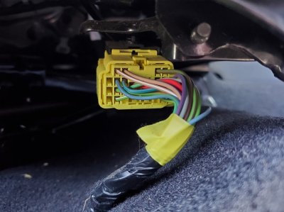

Passenger's Side looks like this.
I believe everything is in place for plug and play installation of heated/cooled seats as well as having the power functions working on both sides. Am I correct?
Ricks Ram
Ricks Ram
May 1, 2015
4,411
3,417
Yes you have all the wiring you will need for the seats to function. You will still have to change the clockspring and steering wheel if you want the heated wheel to work.
