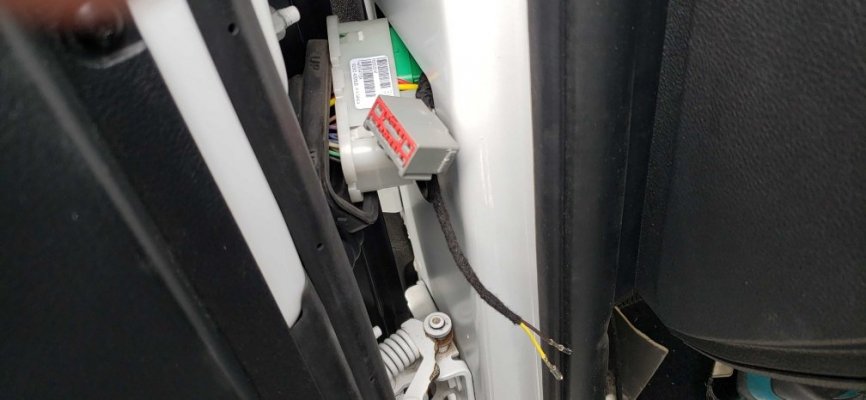

You don't need the memory mirrors for the seat memory function to work The actual memory functions will not work by just installing the two wires from the 5 and #6 pin yellow seat connector to the CAN but you will be able to access the memory seat module at that point because it is then connected to the CAN system. In order for the memory to function you will still need to add two more wires from the #2 pin VT/YL and #13 pin VT/BR from the yellow drivers seat connector to the drivers side door harness that will then connect to the drivers door module. I don't remember what the pin#s are that you pin too in the door connector but all you need to do is connect to the pins that have the VT/YL wire and the VT/BR wire on the corresponding connector. This is a pic of my drivers side door connector when I was pinning the two wires from the #2 and #13 drivers side yellow seat connector and my memory recall functions normally. My memory seat, mirrors,radio and climate control functions perfectly and automatically adjust when it senses my or my wife's fob or I can push the button on the seat.6f1b79fe802c33288fa4e3b2a0b6f23d.jpg8c519c7fff46c19e25c9d32876bc0e0a.jpg4e26c91a8d92fa9e35d3c003cdd64f4a.jpg
Sorry, did not mean to cause any confusion about the other 2 wires that are needed and go to the door connector. JoeB and SawZ were asking about just the 2 wires that go to the canbus, and where to connect them to the canbus, and advised them of the correct location of the canbus for just those 2, so I did not make mention of the 2 door connector wires. To add to your post, #13 (of yellow connector under seat) goes to #3 of door connector and #2 (of yellow connector under seat) to #10 of door connector.

No confusion at all. I just wanted to clarify that just hooking pins 5 and 6 to the CAN will not enable any functions. All you will gain is being able to access the MSM with the alfa tool but you won't be able to run most diagnostics because the MSM isn't connected to the Door Module via the #2 and #13 wires from the drivers seat yellow connector. Honestly having the memory working is now my favorite part of having the Laramie seats. Since it's just a matter of connecting 4 wires in most Quad and Crew Cab trucks I think it's well worth the effort. Single Cab trucks will most likely require adding the wires from the door harness to the door module because they have a different door harness.

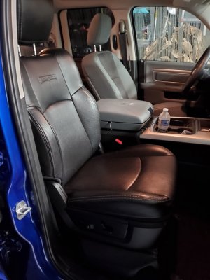

So what do you do when only 1 seat shows up and you are still waiting on the other? Install it, that's what. Electrical functions all work on the passenger seat.
Can't wait for the drivers seat to show up to install. Looking forward to the heated seats!

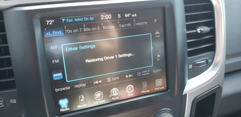

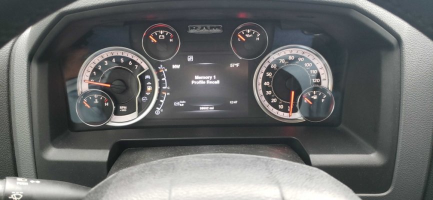

Both seats are in, received the driver's seat a day early! Everything seems to be working with the exception of the memory functions which was expected as I am missing some wiring for the memory function to work. I did notice a small grey connector on the drivers seat that I didn't have anything to plug into it. Checked under the carpet but no loose plugs anywhere. What is this small connector for? small connector.jpg

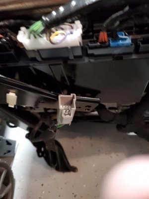

Update. Installed switch panel and no lights coming on. I verified everything is set and enabled in the ecm.. could it be the heater seat module? And does that wiring feed in to the passenger seat?

Yes the wiring should run from your drivers side grey seat connector to your passenger's side yellow connector. When you can please take a picture of your driver's side yellow and grey seat connectors. You should have the wiring but we can 100% verify you do and go from there. All of the seat functions for the passenger side seat except power adjust are controlled from the drivers seat. If you are 100% all of the codes are enabled... ECUconfig#3 front heated seat present, ECUconfig#3 front vented seat present, ECU#4 heated seat present, Memory- Front vented seat present, Memory-seat material type (select perforated leather), Cust-set menu-auto on comfort (select option 2-3) the Cust-set menu doesn't need to be enabled in order for the seats to work but brings the option on the screen to have them turn on automatically on remote start or regulsr start at 40° for heated seats and 80° for vented seats if you chose. I'm not sure if your aftermarket deck will show that or not. If you have verified all those codes are enabled I would have to narrow it down to some type of issue with one of the seat modules or seat harness or an issue with having an aftermarket head unit. Since your drivers seat won't adjust at all I would lean towards the seat possibly being your issue. The radio has absolutley nothing to do with the seat adjusting. Do the heat or vent switches flash at all when you push them? Do your traction control and tow haul buttons still function normally on the new switch panel? As stated earlier you cannot use a switch panel from a 13 unless your truck is a 13. It has to be one for a 14 or newer. You also may want to unplug the driver and passenger side seat connectors and inspect all the pins to make sure none of them are damaged or missing. This mod has been done to many trucks and I have never seen anyone have the same issues you are having. I would also speculate that even though the wrecking yard always says these parts are tested in most cases they aren't. Most of the time the vehicles are to badly damaged to test parts plus the batteries are dead,damaged or missing all together. In order for the the heat and vent functions to be tested the vehicle needs to be running.

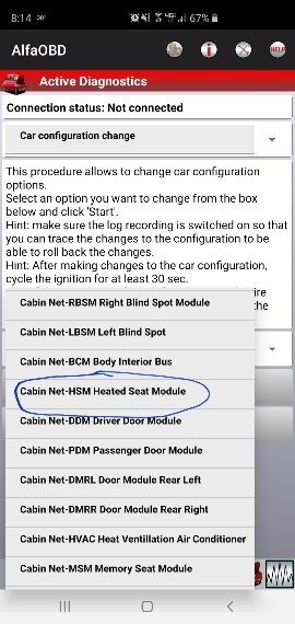

Additional information I just found...My heated and cooled seats have been working as expected including the hardware and soft buttons. I recently swapped radios for a 2018 radio with Android Auto. After the swap, the only soft button available was the heated wheel button. All the hardware buttons still worked, but no soft buttons for the seats. Numerous resets did not help. After taking a suggestion from Mpgrimm2, I compared my file with one from a 2018. I noticed a couple of seat settings for Heated and Cooled under the Cabin Network were not set. After enabling the settings, the soft buttons appeared on the new radio.

Well this worked for me too! I enabled the "cabin net - HSM heated seat module" last night and the soft keys for heated seats showed up on my UAQ radio this morning. Thanks for the insight!c6a27e186609f9930027f616a1642484.jpg
