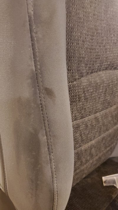

I bought used SLT seats that are supposed to be heated and I don't believe they are. The driver side is power but how can I verify they are heated? I can't get ahold of DeereGuy or anyone else to get a heated/power harness. I've sent messages to him since December with no reply via his website, email, and PM on this forum. The seats are stained and look rough so I don't care to put them in if they are not heated. Any way I can confirm 100% that they are heated without waiting for a harness I may never be able to get anyone to make me one. 119423303f0d9c0149f9035e3e5fd82a.jpg
17' CCSB 4X4 68RFE 2500 6.7 Tradesman DRP EGR delete, CTT tuning w/TCM tuning, UAQ w/7 speed HVAC, 7" premium EVIC, OEM front Parksense, OEM style front camera, aux switches, OEM remote start
Austen.....SLT 2500's do not have heated seats. I also have a 2017 2500 SLT (regular cab) that I ordered and heated seats where not available in that trim level. I added heated/ventilated seats to mine by getting seats out of a Laramie trim Ram. On another note, keep in mind DeereGuy does the harnesses as a second job. I happen to know that recently he has been traveling extensively for his main job and some of that has involved travel to far places internationally.

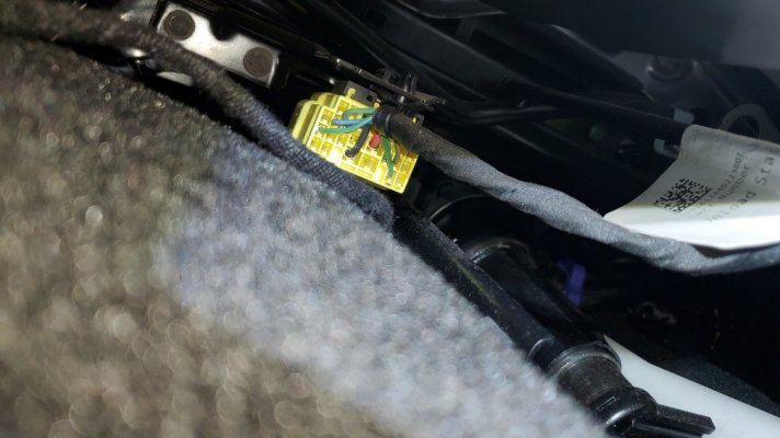

The the passenger seat is the only seat in right now as I didn't realize they might not be heated until I switched the passenger out. Here is a picture of the back of the passenger seat plug. 98c1b5533134d4dc13586e1583568475.jpg
It doesn't appear to be a heated seat. You would need to have these three wires in the yellow seat connector. Pin#3 TN/DB Pin#4 TN/WT Pin#5 LG/VT there are some wires covered by the main black wire on the top so I can't say for a 100%. Check and see if you have those wires. If you don't it's not a heated seat.

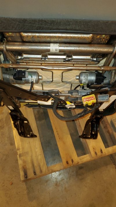

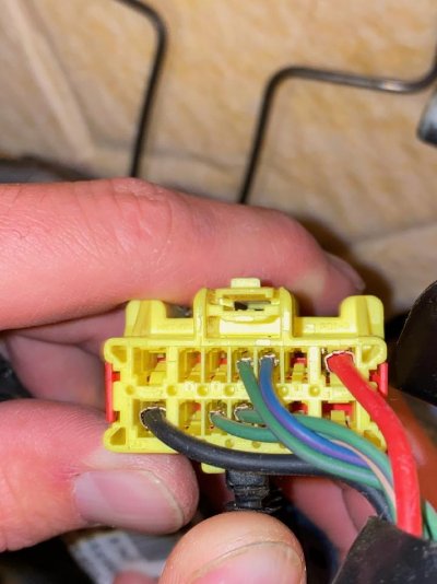

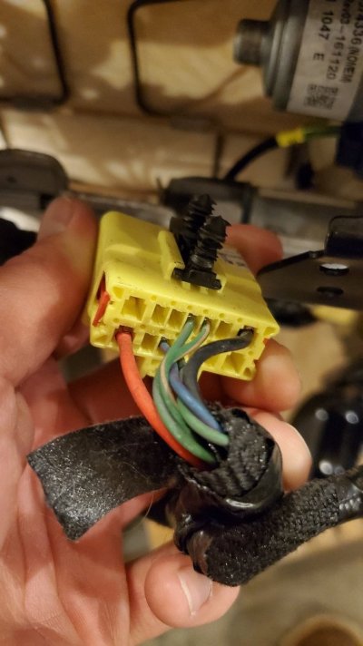

This is the back of the driver side seat connector06e9c7c125ebf131fccdfe6d19c56e9b.jpg
I don't sea the Heated Seat Module so it's not a heated seat. If it's a heated seat it will have these wires in the yellow seat connector Pin #5 WT/LB wire Pin#6 WT wire plus a TN/WT wire a TN/DB wire and a LG/VT wire in the grey seat connector. Unfortunately it's not a heated seat.
Thank you Man I appreciate it. Not very happy now that I was told these we heated.
