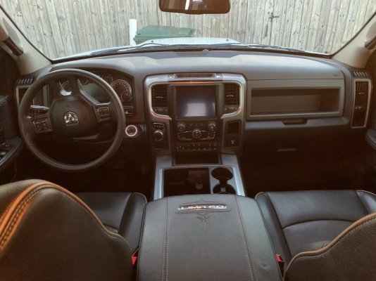

2015 FrankenRam (Limited Tradesman)
Finished up my install today....huge thanks to deereguy, he really makes too notch harnesses and it helps greatly when doing the upgrade. All functions working good, just waiting for xm to come back shortly. 47aad267fa341bb3d82ca69f87c6e828.jpgbe347769c1e3665886d130bbe2b9eacc.jpg

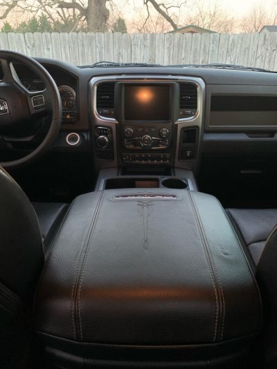

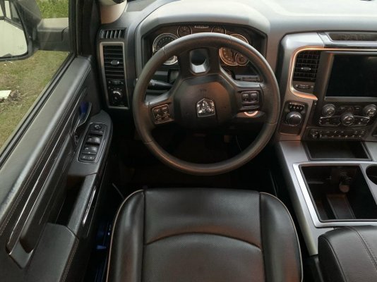

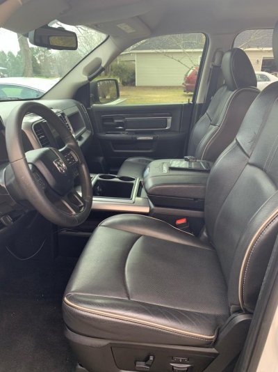

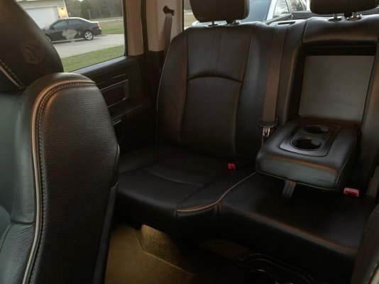

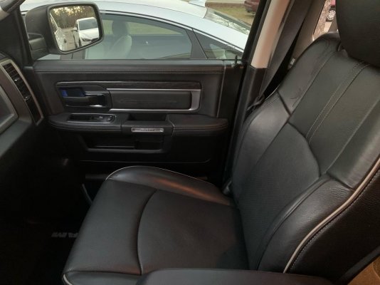

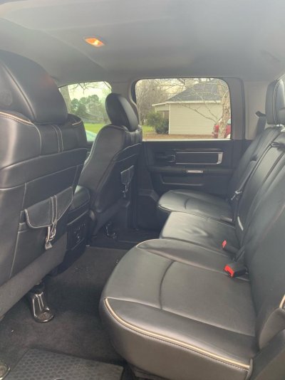

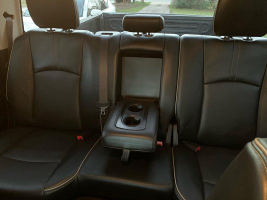

Finally able to grab a couple decent pics after all upgrades. I have done premium cluster, 8.4 UAQ, laramie limited door panels and limited seats. All pretty large challenges going from a 2015 tradesman. Could NOT have done it without the help of great members on this board!! Thank you to all! 9294645a99095039fe25b0cb36817d65.jpgca0f2dbb03704973ecad09c627a83f40.jpg968e8d0b0b645d58b7427c1e6e6320f9.jpga821988936a471418040719df2f905b9.jpg3f091a9bb777522094a901ebe17e4ef6.jpg5102584ea3cef2433734a0d915a2fc39.jpg

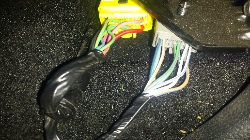

I have all the parts I need to install the rear heated seats in my Quad Cab. I only need to run the wires from the i401 plug to the seat plugs i460a and i470a. I'm searching for the pins needed for the i401 plug under the drivers seat. They are part number Yazaki 7116-4721-02. The only place I can find them requires a minimum 100 qty for an order, a bit overkill for what I need. Looking for anyone that has some of these pins (7116-4721-02 or 7116-4721-08) to purchase a dozen of them from.
Thanks,
Sawz

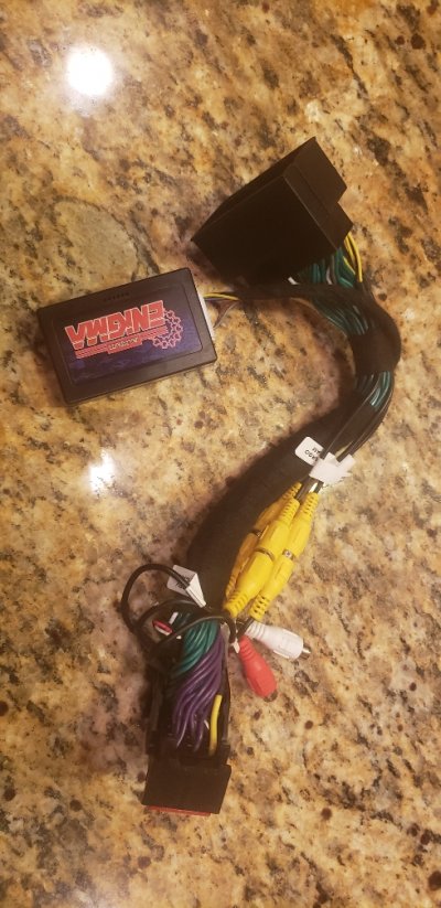

KYLE DESROCHERS
Feb 6, 2020
6
redding CT
6.7

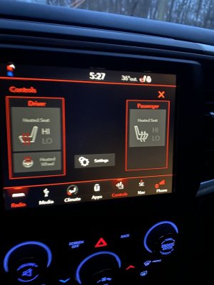

I recently put heated cloth seats, heated wheel with clock spring. And the drivers seat and wheel turn on when it’s below 40. I turned on the heated seat and wheel setting in bcm with Alfaobd. The issue is the controls are locked or not working. They show up but I can’t make them go on and off. Any ideas?8BDC38DC-951C-42F6-8A8F-03A233FC2493.jpeg

I recently put heated cloth seats, heated wheel with clock spring. And the drivers seat and wheel turn on when it’s below 40. I turned on the heated seat and wheel setting in bcm with Alfaobd. The issue is the controls are locked or not working. They show up but I can’t make them go on and off. Any ideas?View attachment 194465
What year is your truck and is it a 1500 or 2500 and did it come with the radio you have in it? You can turn the auto on comfort on or off in your settings menu on the radio. If you don't have the option in your settings menu you will need to enable it with the Alfa tool for it to appear in the radio settings menu.
KYLE DESROCHERS
Feb 6, 2020
6
redding CT
6.7

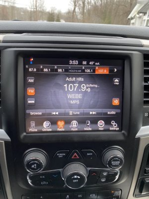

sorry, truck is a 2013 2500 diesel. It has the upgraded 8.4 ucconect from infotainment with apple car play
Ricks Ram
Ricks Ram
May 1, 2015
4,411
3,417
I'm sure it came with the module to let the radio connect with the truck's BCM that goes between the radio harness and radio correct?
KYLE DESROCHERS
Feb 6, 2020
6
redding CT
6.7
The truck had the 8.4 uconnect factory. so the uconnect with apple car play was a direct plug and play, do I need to add that harness to get those options to work? Or do I need to turn on more options with the alfaobd?
Ricks Ram
Ricks Ram
May 1, 2015
4,411
3,417

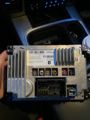

No, the UAQ and UAS radios will not communicate with the BCM on the 13 and 14 1500 and 2500 trucks and some of the 15 2500's for certain features. I know it's needed on the trucks that have been upgraded from the smaller radios and I'm pretty sure even a 13 or 14 truck that came with the RA3 or RA4 radio would need the module if you installed the UAQ or UAS radio. It is a module that connects between the radio and the trucks radio harness. Usually the seat controls are one of the options that won't work correctly without the module. These are pictures of the Infotainment unit which is the larger one and the Customtronix Enigma unit that does the same thing plus corrects some of the other issues the radios have communicating with the trucks. I prefer the Custimtronix Enigma unit but either will work. 451991bf439b0494bbce786a7a968cea.jpge5ec3471ae9a3ee89ba0a3465e3edae3.jpg
