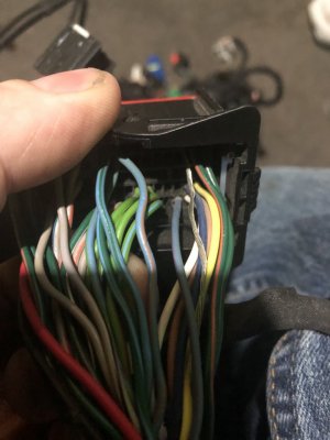

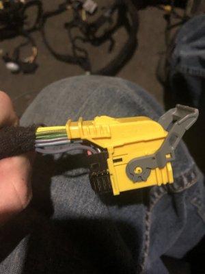

image.jpg image.jpg I’m looking at the plug at the back of the radio
I’ve traced every wire in the back I know where every wire goes except one it’s in pin number three
It is a Blue wire and a Purple stripe
I can’t find it Tech authority
I have a complete wiring harness out of the dash and I can tell you it goes to a yellow connector but I can’t figure out where that goes
I know it ends up in this yellow connector that I took a picture of but I don’t have any idea where it even goes in the vehicle
If anybody has an idea it would be greatly appreciated

Well I figured out the yellow connector goes to the rollover sensor
But it makes zero sense to me why that the radio would be up to that rollover module
I got a suspicion that the problem probably is that I actually need the line bus signal connected to the radio
scratch that after getting a hold of the plug diagram there is no pin available four line bus

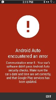

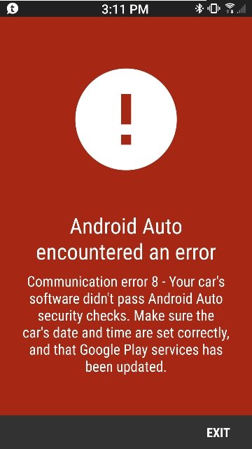

However, now it appears the time isn't updating. I can set it but it just stays the same and I get this error from Android Auto when plugged in. Anyone seen this time issue before?
Edit: it's only been in for about 30 minutes. Maybe I just need to be patient...

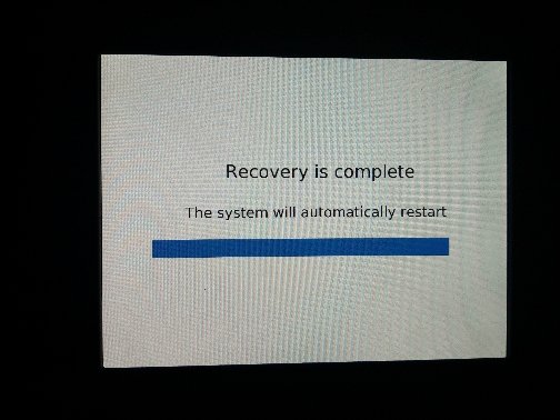

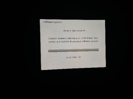

Well that didn't work but it recovered ok...454df284920b06e922f00664d6901f05.jpg4fb9211365d1ce183b96b74c9eaa7fd4.jpg

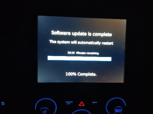

Victory! Switching to a different USB drive worked. Originally I was using an 8GB formatted fat32. I then switched to a 32GB formatted fat32 and the update completed (no error 20). Here is the USB I used...
SanDisk 32GB Ultra Fit USB 3.1... https://www.amazon.com/dp/B077VXV323?ref=ppx_pop_mob_ap_share
I still have the Android Auto issue after updating to 22.6 though but CarPlay works fine.

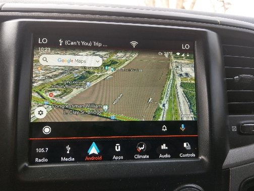

I have a small update. I'm able to get Android Auto to work so long as I first uninstall the app from the phone and then connect the phone to the truck. When connected, AA launches as normal and prompts you to download and accept permissions. Once done, AA works as normal BUT only the very first time.
As soon as you disconnect its back to the error 8 screen

Ok, here's the fix should any of you run across Communication Error 8 when connecting to your UConnect systems for Android Auto...
First Uninstall Android Auto from your phone
Then download the latest release of Android Auto Here (the version in Google Play is older for some reason) and install it.
https://www.apkmirror.com/apk/googl...ging-5-1-500644-release-android-apk-download/
Then connect your phone to your truck and answer all of the permission/setup prompts. You should now have working Android Auto on your Uconnect system.
I found one other Jeep user who posted on this. I imagine it was just that last January update that broke it and/or the fix wasn't implented until this latest version of AA. I haven't had the radio long enough to say for sure...
EDIT: this error popped up again after resetting my phone. The aforementioned fix wouldn't work. I ended up having to remove the radio fuse and letting it sit for about 15 minutes. Once I restored power AA worked as expected.
