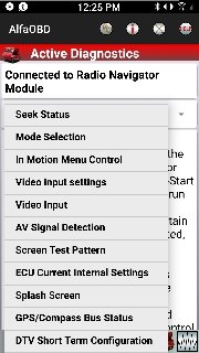

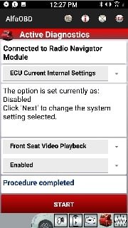

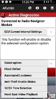

So now that I have everything working I thought it's time to (possibly) break stuff. There are some settings I want to see if they do anything.
There is a settings menu in the radio navigator module you will not see until you connect to the radio called "ECU Current Internal Settings".
So far, "Clock Defeat" does remove the time from the radio.
I've enabled "Front Seat Video Playback" to see if this will keep the cargo camera on in motion.
