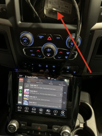

The arrow is pointing to the radio module, and it is part number 68307655AI- el2qmEV.jpg It won’t mount in the original holes because it’s too wide, so I just stuffed it in there sideways for now. The display screen is part number 68356773AD. It is just a flat screen with screw hole mounting tabs, and the existing 4th gen radio bezel will definitely have to be modified a little bit to mount it. You also need the LDVS cable part number 68082364AC that connects the display screen to the radio module. Then, a conversion “Y” cable needs to be made so the 8 pin connector still plugs into the existing HVAC controls switch bank, and also plugs into the same 8 pin connector on the display screen (the pins switch locations on the connector, though). And, finally, you need the windows version of AlfaOBD to be able to enable the display screen module under cabin net. You need the windows version because you have to connect to your truck’s BCM under MY2017 Pacifica, and the Android version can’t do that.

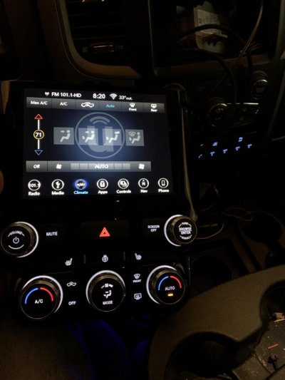

I have confirmed that the 5th gen bezel with the HVAC controls works- AeFHSSj.jpg
That entire bezel can be fitted to the center stack with some careful dremel work, but the only thing that sucks is, the controls backlighting is white, as opposed to blue on the 4th gens.

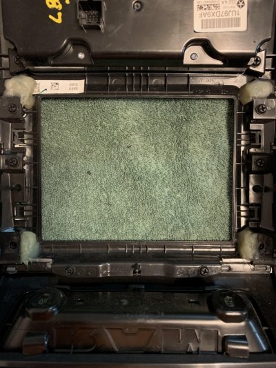

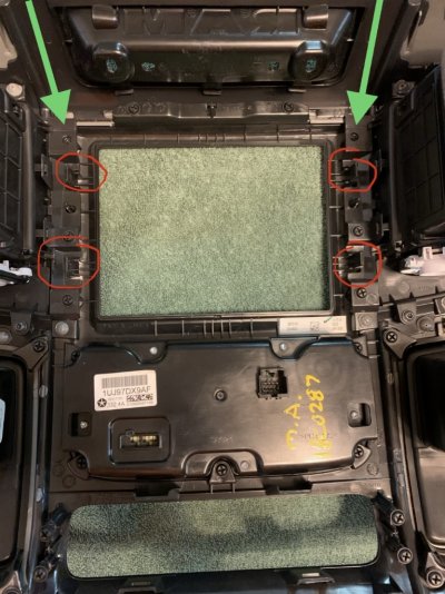

I do have an extra bezel, and I just got the chance to figure something out. I couldn’t see any way to cut and reuse any clips, so I went ahead with loctite plastic bonder to build the mounts. I removed the two screws that the arrows are pointing to, and had to cut off the clips that are circled. These are the clips that pop into the original radio metal frame slots. (This is done with the bezel mounted in the center stack)fV99GnC.jpg
Then, I built up the four corners with the plastic bond. Once it dries, I’ll clean it up with the dremel, drill the holes, and screw the screen down. rcb2oQa.jpg
Going with this radio is definitely not a practical solution for those just looking to get an 8.4 for the CarPlay and Android Auto. I got lucky on this with a junkyard that didn’t seem to know what they had, but the screen and module usually go for the same price as a UAQ. Then you have to buy the cable, and make a Y harness, and the mods to the bezel. The only reason I got this is to try to get factory surround view working.

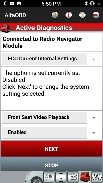

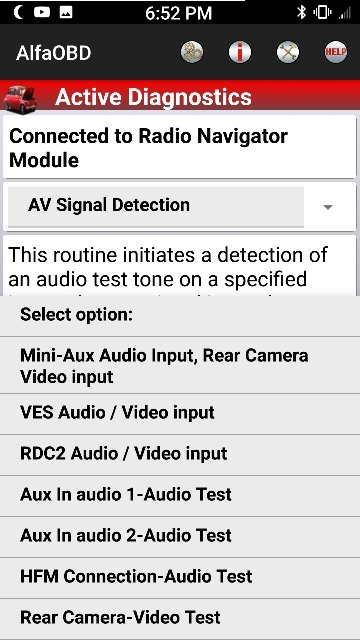

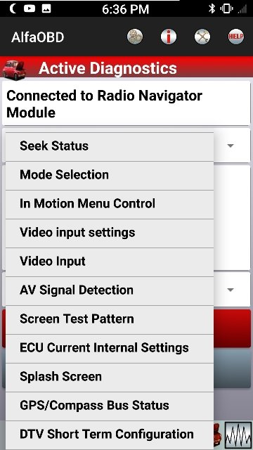

Any of you connected to these radios with AlfaOBD before? There are some interesting settings...22e3895f86df897a5323b5fbe44544c8.jpg812f1f07943b1be4ab737c63bb66f9be.jpg02139d9e864e3c06927d25af2bf7ebcb.jpg
