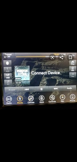

Anyone know if changing both special packages with Alpha OBD to Jeep will give you the ability to choose from different radio themes such as this one on a Ram UAQ without causing any issues?3fc82c5c450bfdc38b9d24850704f2d4.jpg

Yes it'***** and miss. I forget (and am unsure) exactly which setting will change the skins but it can be done. I've had mine display Dodge, Ram, Jeep etc when fooling with it.

Is yours a UAQ? I just don't want to cause any issues by changing the special package to anything other than Ram trim levels

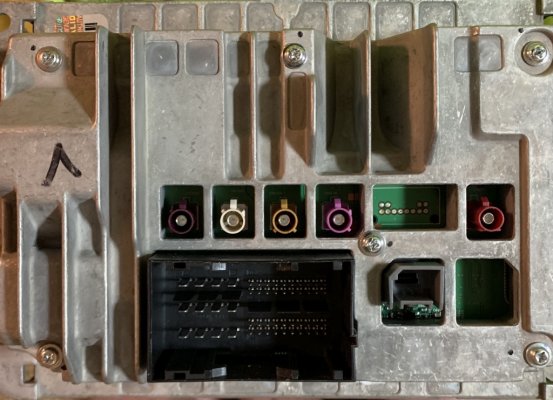

Anyone ever see this connection (the black rectangular Molex) on the back of a UAS before? If so, do you know it's purpose?5e6d31e2d54902f7c9bf5a19d4d08162.jpg

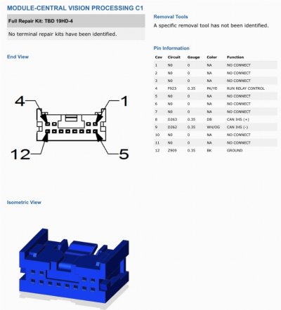

Hmmm...that looks suspiciously like the the C1 connector of the 5th gen’s central vision processing module. 8cDfn3N.jpg
I’ll bet you need that connection in order to run the 5th gen digital backup camera through the red fakra connector to the right of it.

Interesting thanks! This is from a 2018 Ram 1500 UAS (68331635AH). I wonder if I should look into keeping this one instead of the newer one I have just in case something useful can come of that connection...

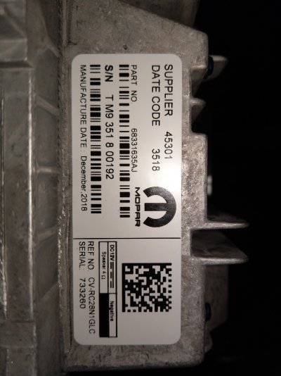

My 2019 UAS from a 1500 Classic has it. 68331635AJ

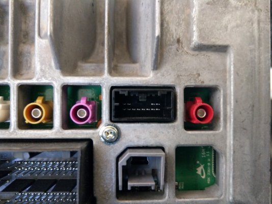

I stand corrected. I'm looking at a 2018 UAQ that also has it.
In addition, I currently have a UAQ and a UAS open to compare internals and so far I see zero hardware differences? So far everything looks identical? Makes me wonder...I think I'm going to see what happens with a FrankenUconnect.
