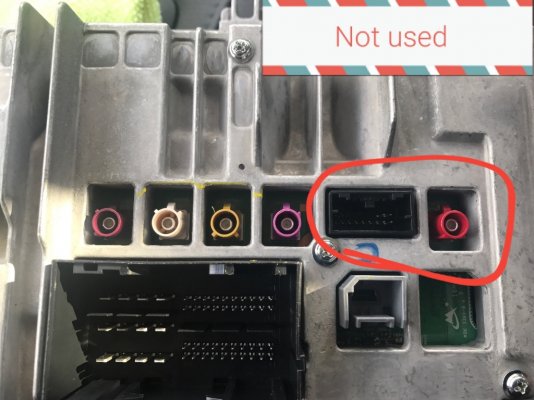

I’ll open it up and check. I did disconnect the small connectors in there. But I did reconnect them. There’s only 1 spot they can go. After looking at Powerwagons diagram. The violet (H) connector is open on my deck after I connected everything. I’m gonna try moving the purple cable over and see if that works

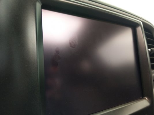

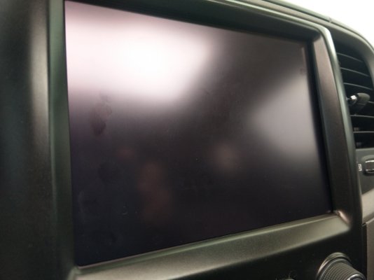

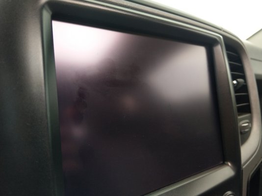

I've only had it in for a few days but it doesn't appear (so far) to get very printed at all. I'll take some pictures later today and post them. I'll also open the sunroof for a real good test.
I will say I haven't seen a matte screen protector quite like this. It is fairly thick and resilient but not blurry or cloudy when installed.
SitKneelBend
Moderator
Member Relations Specialist
Jan 8, 2015
11,004
7,717
St. Louis
3.6 Pentastar
@SitKneelBend how prone is this one to showing fingerprints? I have one now and I don't know what brand it is but it shows everything.
Seems to do well with fingerprints. Barely noticeable until I swiped behind my ear to really oil it up. It actually wiped away pretty easily with my other finger? Any glare you see in these photos is entirely positional and generally not noticeable from the driver's seat. It also is exaggerated by the camera and not as "glaring" in person.
Fingered...
Oily fingered ...
Wiped by finger...
Driver view screen on sunroof open...

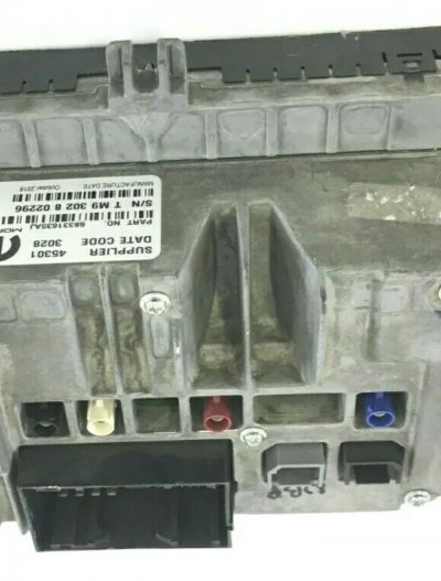

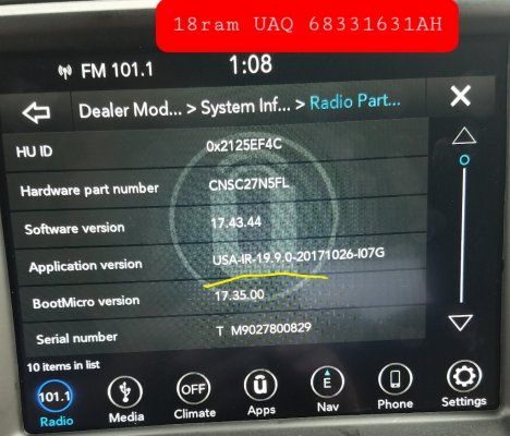

A word of caution for those looking for a ram compatible 4th Gen 2018/19 classic UAQ or UAS radios...
** Not saying what's good, what's not, or whether it 'Can' work. Just be aware of what you're getting **
>> If you find a radio n and know it came out of a ram truck from a salvage yard, etc (ie with vin) and has has one of the 2 PNs listed in the OP, you are much better off <<
There's an eBay seller (lombeephre) repairing radios and I'm fairly certain he's mixing rear cases with different PN radios/internal hardware and the SW I see loaded doesn't look correct either. (ie application version shows non USA country & version # )
For example:
Rear view of a factory 2018 ram UAS (68331635Ax) and UAQ (68331631Ax) radio ... 7494d84907ec9d4d36f8e955169f79d6.jpg
And here's the 2018 UAS (68331635Ax) that's currently listed. See the difference in the connectors? (It's likely from another 2017 Chrysler brand ...
This UAQ (68331631Ax) hardware looks correct physically but appears to be running a Jeep Sw load (fairly certain, Jeep got a different hardware PN than the RAM) ... See the menu icon differences. (Radio may have just loaded the Jeep theme if bench test SW is saying it's installed in a Jeep)
Here's the factory RAM UAQ SW icons (application version 18.x to 22.6) ...
2018 ram UAQ (68331631Ax) Application version screen...
