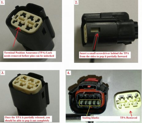

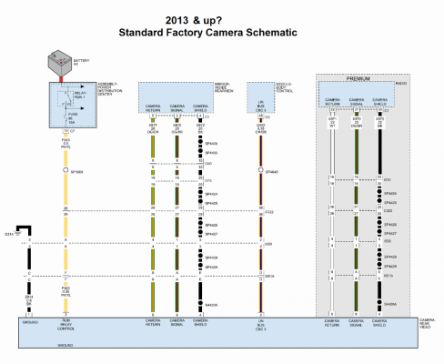

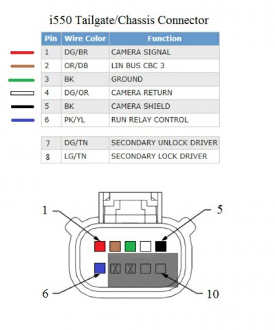

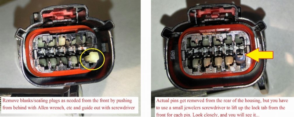

Just remembered this which may help...
Try depinning/disconnecting the LIN BUS CBC3 signal (from BCM C5/e-45) to the camera at the 8pin tailgate connector (pin 2 org/DB wire)... As long as the radio will switch to the input (ie blank screen in reverse), the camera should be forced to send it a video signal although it will be without the gridlines. (Camera will output video as long as the truck is running)
I'll edit this post with more information once I find the details....
(Related camera thread post 919)
Edit:
Wire insertion side
(ignore my added colors from another project)
c419d6be9874f9d6cd043fd1c1dbc4f5.png8fbbe5046b141fd9e45e705552dc5666.jpg1190d468b7819a51a7ffdd8712647821.jpg
Edit:
Wire insertion side

Digging through schematics more, the security gateway on the 2018s might be the reason for this behavior (or lack thereof). The following schematics show the CAN-C and the CAN-IHS bus lines for the 2018 2500:
https://mopar1973man.com/external-media/image/4thgen/2018wiring/canbus/canc.png

Both of these show that the radio connects to the security gateway via a different CAN bus (CAN-C AT and CAN-IHS AT). Not sure what AT stands for in this but they felt the need to differentiate the CAN communication between the security gateway and the radio as something separate from the other modules on the network.
I'd accidentally bought a security gateway instead of an HVAC module when collecting parts for this upgrade and haven't returned it yet so I think I'll ohm it out on the CAN pins to see if this really is just a passthrough or if something's happening between. If this is just a passthrough then there should be continuity between 4-5 and 11-12 as well as 1-3 and 6-8 on the gateway module.
If there is a difference, I'd like to try putting this gateway between the vehicle CAN system and the radio's CAN inputs with a pigtail of some sort. @Mpgrimm2 I may be hitting you up for some radio connector info here soon.
From scouring the forums on this issue, I know @ManualCummins started down this path but I'm not sure how far he got into putting the security module into his truck.
