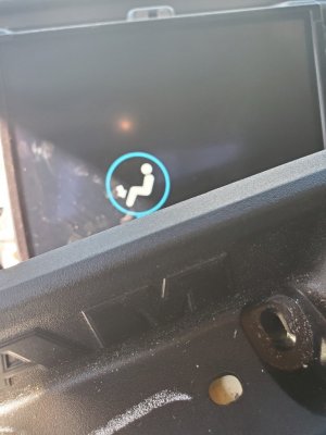

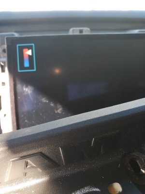

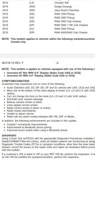

Anyone ever swap in a UAQ and the screen is black but shows the ram logo when switching off? Unplugging it and pluging back in shows the sirius xm screen, then goes black. Evic shows locked. Tried a soft reset with vr and phone, no-go. Waiting on harness for mute/browse reset or temp button trick.
If you have AlphaOBD, you may be able to connect directly to it and see if there is a setting to flip. I've heard this recently here before, I wonder if it's the same radio?
I also wonder if this is the behavior when a radio is actually reported stolen?

It came out of a wrecked renegade. I may have found my answer the firmware is 21.9 I need 22.6
It should be working on either version but an upgrade may revert it to prompting for an anti-theft code. It may be worth asking a dealer if they can see if it's reported stolen.

I do not have a backup camera. I did stumble on something odd.. the screen stays black, if I mess with the tempreature controls, the temp and position pop up.
Does not look like any logos or icons I’m familiar with in a Ram. Have you tried loading Ram software? What is the radio part number?
Bloup i have not loaded the ram firmware. Waiting on the harnesses. The part number is 68366554AB. It is from a wrecked jeep. I seen a guy on here with 68366554AA and his swap went ok.

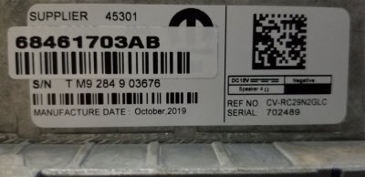

Does anyone have any information on a part number 68461703AB? The scrap yard has it out of a 2019 big horn classic

Here is a close up of the part number tag, I'm not sure what part number is under the cover up tag though

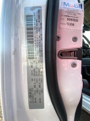

The vehicle VIN is 1C6RR7TT0KS730176
The build sheet for the VIN checks out as a 2019 Classic (4th gen) Bighorn with an 8.4 4c UAS radio & a lot of options. (Enterprise rent a car) . Enter VIN here.
I can't confirm that PN, but if you trust that the salvage yard gave you the correct VIN for the radio (ie actually came out of that 4th gen truck?), I would expect it to work.
If they accept returns and you take a chance on it, please report back.
Edit: quick Google search of that PN shows it as listed pn for a 2020 Ram 1500 classic
UAS 4c Radio: 68461703AB.

The build sheet for the VIN checks out as a 2019 Classic (4th gen) Bighorn with an 8.4 4c UAS radio & a lot of options. (Enterprise rent a car) . Secret VIN here.

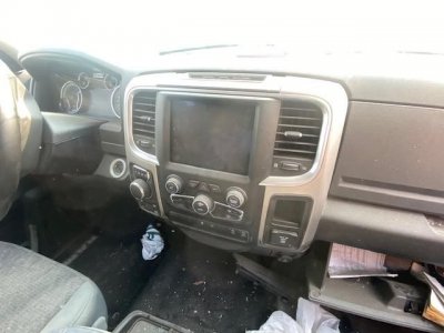

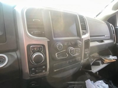

It seems pretty legitimate, here's pictures of it in the truck before they pulled it. The price was only 250 so I figured I'd take the chance. I will definitely report back. If it works then I will be PMing you about an HVAC harness (with the dual zone ATC as well because I plan on doing that upgrade in the spring)

If it was me, I would get it.
M² Mods.
I called them up and ordered it, should be here by this weekend hopefully. Makes sense as I'm sure the late 2019s and 2020s used the same part so good to know it checks out. The google search I did kept showing it as just a "multi media radio" but I couldn't verify the year, so thank you for that! Worst case scenario I return it, best case scenario I got a killer deal so I'm happy either way.
