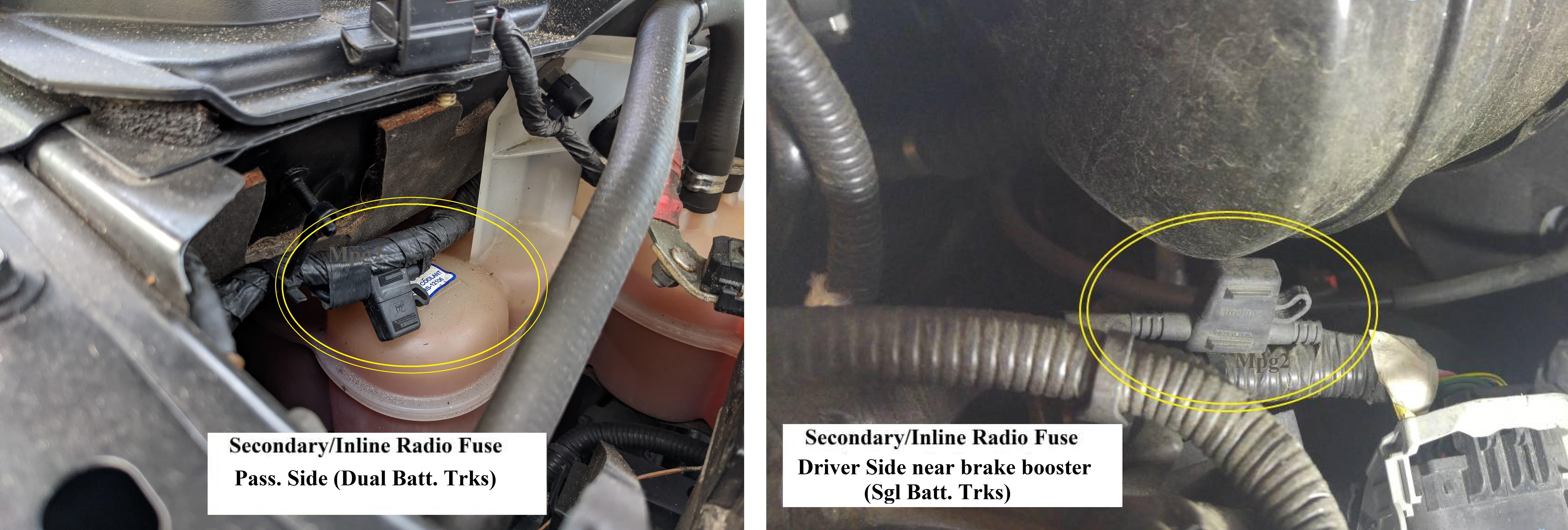

As indicated, 4th gen UAQ & UAS radios require an extended period of time to finish a reset and read out the truck configuration from the BCM. Posted this elsewhere ...
NOTE : Battery disconnect or pulling the 20A inline radio fuse near the brake booster for 1-2 mins (Pass Side firewall on Dual Batt. Trucks) ... between these changes can speed up the radio/BCM reset for changes, especially with a UAQ/UAS radio (think 15-30mins or more).
* Radio is not reset until SXM button displays again and/or Backup Cam works if installed)

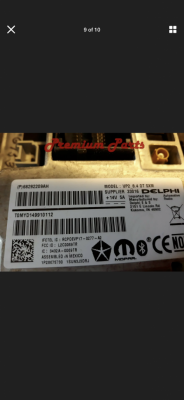

It has been in for 7 days and I have tried the inline fuse pull for 30 mins and the battery disconnect for 30 mins and it didn’t seem to do anything but here is a pic and thank you for the reply.

That's a 5th gen 2019 'DT' 1500 Delphi radio (68292209Ax)
... instead of a 4th gen 2018/2019 classic DS 1500 radio.
Those problems will not go away unless someone has found a work around (someone else tried that radio back in the thread... Somewhere)
Known good 4th gen ram PNs are in the OP (68331631Ax or 68331635Ax).
