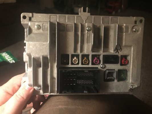

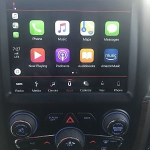

For the 2018 model year RAMS, the 8.4 Radios were changed from the previous VP3/VP4 Harman radios to the 4C/4C-Nav radios made by Panasonic. The biggest advantage of these new 4C Radios is the support for Apple CarPlay and Android Auto. The radios themselves fit the same mount as 2013-2017 RAMS and the radios require no special programming to work. They read the BCM of the truck just like the VP3s/VP4s. However there are some known issues and components that need to be changed to make it work 100%.
Thanks to MPGRIMM2, RICKS RAM, 00R/T, and STDECO for volunteering to test these radios in their trucks. As a result, we have had them working in a 2013, 2014, 2015, and 2016 trucks. We have tested seats, backup cameras, cargo cameras, android auto, apple car play, and most of the radio's standard functionality in these models.
There are two distinct versions of the radio. The 4C (Sales Code: UAS) and the 4C-Nav (Sales Code: UAQ). The only difference between the radios is that the UAS does not have built in navigation and the UAQ does. Both units support CarPlay and Android Auto. However, unlike the previous VP3 radios, Built in navigation cannot be purchased and added to the 4C radio.

It is important that you get a radio that has the correct mount as the mount is now forged as part of the radio housing. Even though a radio out of an 18 Charger/300/Durango/etc will technically function the same as the RAM radio, the mount will not fit the RAM. Can these radios be modified to fit in a RAM.. Maybe, but I wouldn't recommend it. I broke a screen trying to transplant a UAQ radio into an existing VP4 mount.
It is also important that you get a MY18 radio. All MY18 radio part numbers start with 683.... The RAM themes are only available on MY18 year radios and the firmware must be at least version 18. There is a round colored dot on the top of each radio that has a number in it that reflects the firmware version that the radio had on it when it shipped from the factory. Anything less than 18.7 may have functional problems. It is possible to upgrade radios with older versions of software (I have upgraded to 18.14 all the way from 15.5 on one radio) but I also had one fail the upgrade process. Be wary of "AA" revision radios as they are really a crapshoot of what you are actually going to get.
As of now the radio can be purchased brand new from FCA. The cost is around $1200 for the UAQ, and about $100 for the hub.

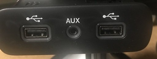

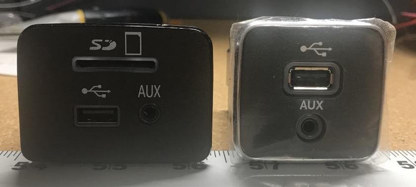

The media hubs in pre 2018 RAMs will not work with the 2018 Radios. Unfortunately RAM changed the form factor of the media hub in the 2018 RAM Trucks. The 2018 hubs are oblong in shape compared to the square 2013 - 2017 hubs. The closest compatible hub that will fit the existing opening is the compass hub. It is not an exact fit, but it generally fits. Changing the hub in a center console truck is easier than changing it in a jumpseat equipped truck.
2018 RAM HUB

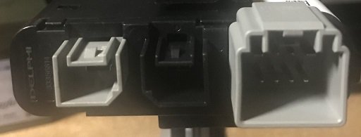

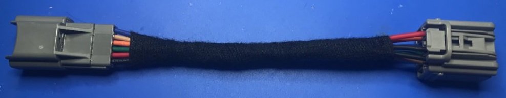

The connector on the rear of the media hub is also different, so a conversion harness will need to be built to adapt the current 6 pin connector to the 8 pin on the new hubs.

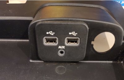

Jump Seat Insert Replacement
Trucks that have a jump seat can order part number 68376066AA which is the insert with the correct cutout for the 18 RAM USB Hub. The cost is around $95. MPGrimm2 has recorded several videos showing how to change the insert.
See his full post here: Jump Seat Insert Replacement.

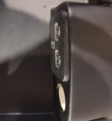

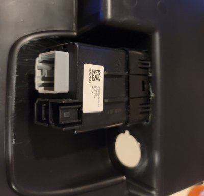

Hi you can use this hub too it can fit with little sanding and it work with the carplay this way don't have to replace your top

    1. Ram (P/N 68328704AC) - dual USB with AUX inputs. Requires modifications or additional parts for installation.
    2. Compass (P/N 5XG28DX9AC) - single USB with AUX input. Requires minimal modifications, but does not fit previous hole perfectly.

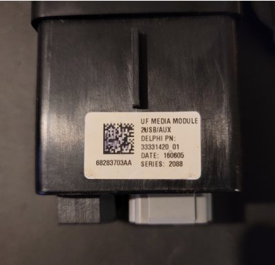

    3. 2017 Chrystler 200 (P/N 68283703AA) - dual USB with AUX inputs. Looks like it may fit existing hole well with minimal modifications.
    4. Ram USB-C (P/N 68272254AE) - dual USB & USB-C with AUX inputs. Requires modifications or additional parts for installation. (please confirm part number is correct- I also saw P/N 68397098AE listed in this thread. Not sure of difference)
  3. Hub Harness - contact M2 mods

Is there any advantage of using the dual USB hub from the 200?

As far as the dual USB hub from the 200, if you look a few posts up, it appears that it may be a better fit to replace the existing hub from a fit, form and function perspective.

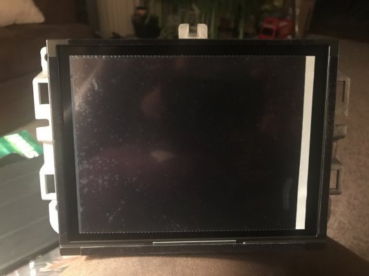

I fixed the darker backup camera problem by putting in a camera manufactured for a 2018. I bought it from a 2018 wreck, and it has worked great.
