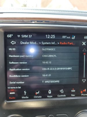

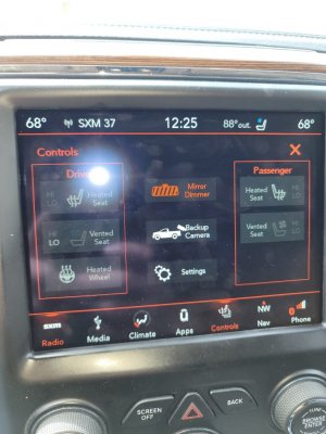

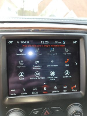

I know there were a couple of people on here asking about progress with my 2016 2500 UAQ swap. I have tried two seperate radios (both from infotainment.com), replaced the Heated Seat Module to latest revision, tried everything I can with AlfaOBD, ordered the wiring harness infotainment sells for the 14 trucks, and even had the firmware of my BCM updtated by the dealer this morning. Nothing has worked. I cannot get the heated/cooled seat controls on screen to work. I don't have hard buttons for this function as my truck has factory upfitter switches. I can see the buttons on the screen but they are greyed out and do not function. If the ambient temp is low or high enough the seats will come on automatically but I cannot control them. If I turn off the auto on in comfort features and start the truck with ambient temp low enough, then re-enable it for all starts they will come on but again with no control over level or being able to turn them off. Does anyone have anything else they would suggest? I am at my wits end with this thing.

Awesome. I will need any tutorials you might be able to provide as well as I am competely novice at this kind of stuff. I do have the ability to send CAN commands through my tuner (EZ-Lynk) if that is a possibility or easier. I ahave also attached some screen shots so we are on the same page.
