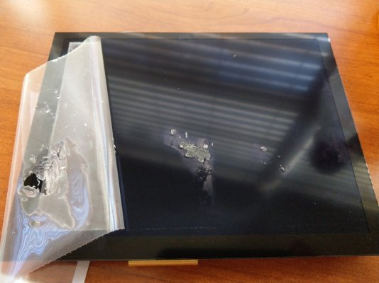

I can't edit my post for some reason but just wanted to say if you go to remove the factory anti-glare screen its easier (and probably safer for the screen) to just use a razor blade. The glass on the digitizer is pretty tough.
Do you have to remove the factory anti-glare screen or will putting a Brotect over it help with the scratches / blotches? For some reason I thought you just put the Brotect over what is there.
I have the Brotect ... but have not got around to pulling the bezel again to install.
SitKneelBend
Moderator
Member Relations Specialist
Jan 8, 2015
11,000
7,710
St. Louis
3.6 Pentastar
I've done it both ways (over factory and factory removed) with great results. My UAS has it over the factory and my UAQ has it directly on the factory glass.
If your factory protector is gouged down to the adhesive, its best to remove that protector. I went from this...
To this...
Buying a damaged/defect screen was the only way to get a reasonable price on a replacement screen now ($237 vs $500+).

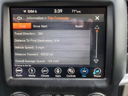

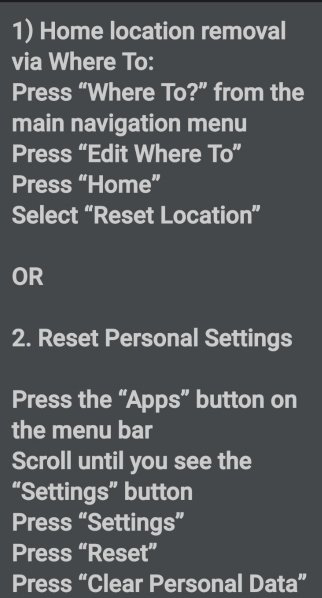

I just installed a uaq from a 2018 RAM into my 2019 Classic.
Everything works (I think) except I have blend/temperature issues. Waiting on harness to convert to ATC.
Just the difference in the back up camera image (over the ra2) makes it seem like a new truck.
To test the navigation, I set destination as home. Home seems to be a few thousand miles off. I spent a few minutes trying to figure out how to change the address for Home, but gave up. I'll try again later. So, for now the radio thinks home is in Michigan.
randerson0248
Feb 20, 2021
30
18
Northern California
I still don't know how to change the previous owners home address to my address, but I did find this to be interesting. Average mph is 104. I'm guessing to average 104, most of the time speed would need to be 120 to 130.a8d28f8b7266ee093a38e95fee16911f.jpg
Sent from my SM-N975U using Tapatalk
Well your truck was built here in Michigan, so yeah that's home...lol
I believe you have to delete the current "Home" address before you can set a new one.

I saved this from another member a long time ago. I couldn't have found it without his help I guess lol! a3af7b9e2b0adb50c6c791ad717b70c8.jpg
