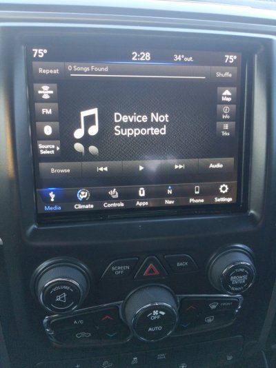

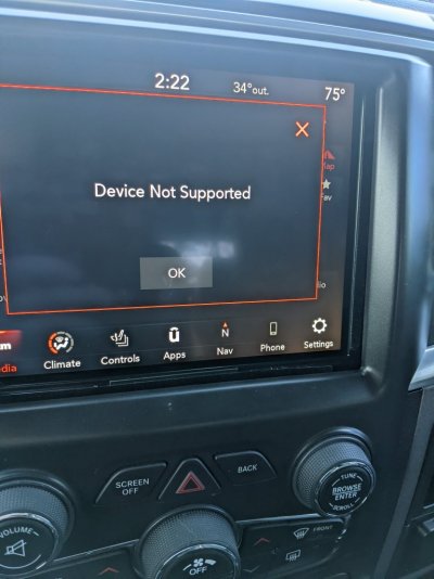

Just curious if anyone else has had this issue and was able to fix it. I recently converted my 8.4A to the 8.4 4C in my 2017 2500. I got it from infotainment. Infotainment has been no help. Everything works but for some reason at start up a message pops up and says "device not supported" with nothing plugged into the USB hub. If I plug in, let's say an iPod to the USB hub, it says "connect device" but music still plays no music info shows. Then when I go to select the USB under the source tab it says "device not supported". It appears that the new USB isn't fully communicating with the radio. Any fixes?
I upgraded my 2018 3500 5’’ radio to an 8.4” with CarPlay and was told that the device not supported error is a quirk of the newer versions of the software on the radio. Apparently nothing we can do about it.
In regards to the USB hub did you upgrade that? I know there are certain versions of the USB hub that won’t work if you have an older vehicle than 2018. Even in my 2018 I had to get a 2018 premium USB hub to be able to have CarPlay to work. I think for your 2017 you might have to get a 2018 USB hub and a harness that connects to the newer hub.
Yeah, Infotainment sent me a hub with a harness with the radio and I installed it. I'll double check the part number on the hub. I just assumed the one they sent me would have to be a 2018+ hub. The one they sent is only a single USB and Aux not double. So I'm not sure what would be causing the issue.
If you don't mind me asking do you have a link to the one you got that worked?
This is the one I used, but I have a 2018 and it was plug and play for me.
@Mpgrimm2 is the resident expert on these radio upgrades and might have more info for you but since you went through infotainment it might be harder to figure out what the deal is.
As Gordo indicated...
UAQ or UAS? What pn is your radio?
What "application version" is your radio on?
It appears to be a radio SW driver version with the USB Hub. a radio SW update appears to fix it. Panasonic radio SW goes by the"application version"
v39.6 is the latest, some have bricked their radios doing the updates... Not sure if they did something incorrectly.
InfoT should be able to give you a link to DL SW update for your radio

So oddly enough I tried just for the hell of it to plug back in my original media hub and boom it works. It's reading everything and I was able to connect Android auto and Carplay briefly but then says it disconnects. But when it comes to the iPod or any music from my phone all info appears

So oddly enough I tried just for the hell of it to plug back in my original media hub and boom it works. It's reading everything and Android auto and Carplay work. The "hub not supported" message shows at start but that's clearly not the case
Curious how your original hub works with carplay considering it wasn't even a thing back in Ram trucks in 2017? As I understand it you need a 2018 premium USB hub (there are a few different versions) for the carplay function to work.
