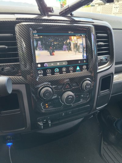

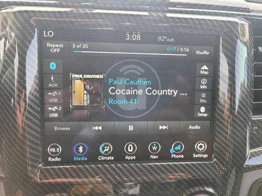

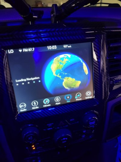

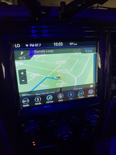

My 2014 Dodge Ram 1500 5.0 to 8.4 NAV/CarPlay upgrade was a huge success...thanks to MP Grimm2! Got my bezel, harnesses, sensors, modules, Media Hub, etc. through him...a lot of instructions as well. The Chrysler 200 Media Hub worked perfectly in my jumpseat console to run Android Auto and CarPlay Just wanted to shout-out my gratitude to the hard-working folks on RamForum like MP Grimm2!
Just wanted to say again how awesome it was to work with MP Grimm2 for my 5.0 Ucpnnect to my 8.4 UAQ upgrade! Everything still works GREAT

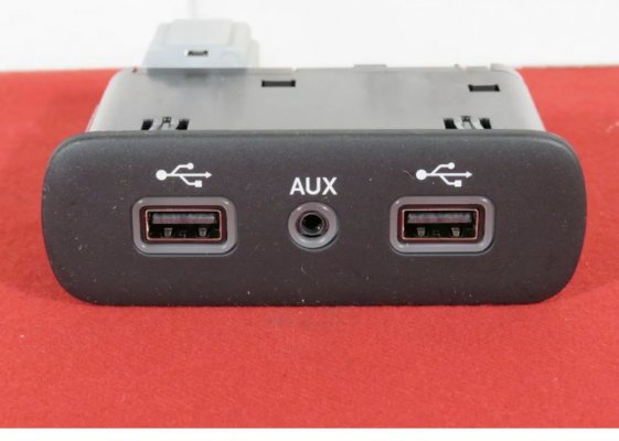

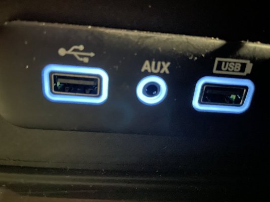

So would the one I need look like this?

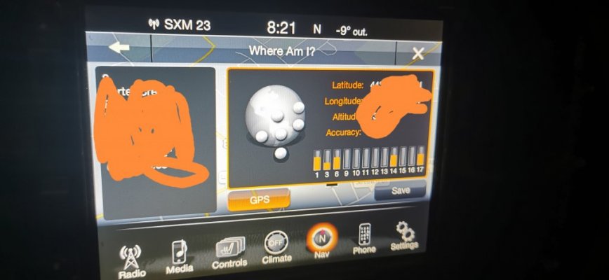

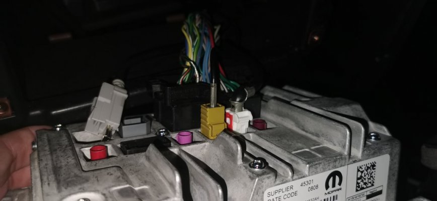

Hi Guys

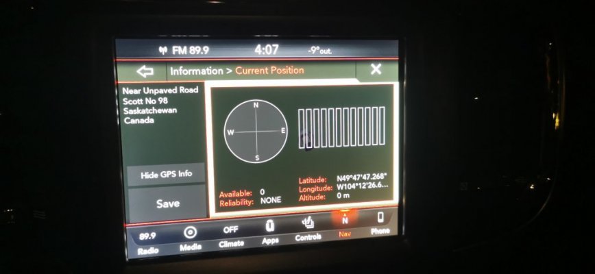

I just installed a UAQ in my '15 RAM 1500. I am in canada and the GPS seems to be stuck in the province from which the unit came? It has been sitting for a couple of hours. Secondly, the unit does not seem to be figuring out that I have alpine sound installed and front door speakers have bad sound. Most sound plays from speakers at the windshield?
Justinb107
Jan 25, 2022
12
Nova Scotia, Canada
Went back to plug in the old radio. GPS satellites connect within seconds. New radio, satellites are dead? Faulty head unit or is there an incompatible GPS reciever? Sirius XM still works and goes dead when I unplug the yellow fakra connector, so that means satellite radio still works.

Ryno1500
May 11, 2021
112
56
California
Hemi 5.7 eTorque
I had a UAQ in my truck, until I bricked it, and everything worked just fine - 2014 1500. Must be a bad unit.
Mpgrimm2
Supporting Vendor Navy Badge
Mar 30, 2014
6,589
5,203
SC
2022 Ram 1500 (5th Gen)
5.7L
** We don't really know what you're working with/what you started with, etc?
What year is your truck?
1500?
what radio you originally had?
(Ra2? W/phone & VR buttons on wheel & mics on mirror/headliner?).
Factory installed 8.4 Radio with Dual Zone ATC?
What year/model & PN 8.4 radio did u get?
( UAS/UAQ or UCS/UCQ? ... Actual PNs please),
Do you have a Backup Camera/Cargo Cam? (Where do they display?)
What parts, if any have you bought for this?
(Actual PNs help)
** After the install, did you wait for the satellite radio & BuCam to start working again before evaluating your setup/install? **
(It's not finished it's reset/configuration until then)
* Also, I have seen 2 or 3, 8.4 upgrades fail Gps or sxm in someone's truck because of a faulty or borderline faulty sxm/gps antenna on the roof. Only real way to know is to test the radio in someone else's truck.
(Yes the old radio may still work with the original antenna).

So Here are the details:
2015 RAM 1500. Factory fitted with VP4 & GPS, With mic's in headliner & rear view mirror, auto dimming rearview and drivers mirror, dual zone ATC with heated/cooled seats, remote start, backup camera and VR Buttons on steering wheel. No Cargo Cam (will be the next installation), but I do have a backup cam with displays on the radio itself.
Here is the original radio part number: 68238626AF. I replaced it with a UAQ part number 68331632AH. The new radio came out of a 2018 RAM 1500 and the build sheet clearly states apple car play and android auto with navigation. No additional parts have been installed or replaced, just the head unit for now. Just checked the truck this morning and all is working except for the GPS, besides that, no issues at all. Would it work if I checked with on of those amazon chinese GPS modules? I have one in the ford after upgrading to the sync 3 radio and cheap fakra GPS antenna.

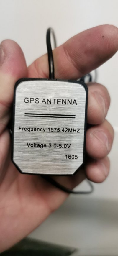

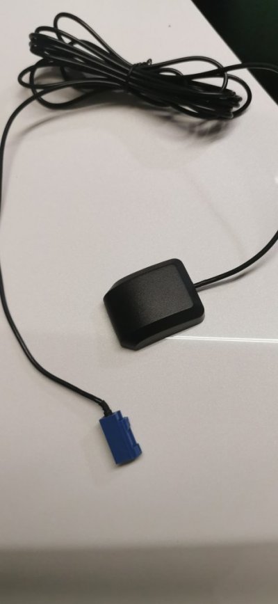

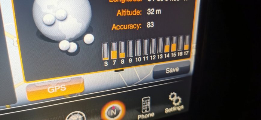

So tonight I installed one of those cheap GPS antennas I took from the ford, I have the same result. Plugged it into the VP4, works without any issue, just asked for a recalibration. I then went ahead and installed the same antenna on the UAQ and still no GPS. I know the antenna works in the ford without an issue. I scanned for fault codes and I get none. Last thing I can think is that I have a faulty UAQ unit?? This is the 4th u it I am testing, but the first one with the correct part number. Others were from 2020 model rams with the new style unit.
