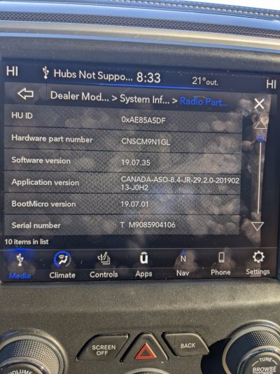

I know you said that infotainment isn’t helping but they sold you the kit and should be making it right, whatever the issue is. At this point for people on the forum to help I think you need to figure out what part number the radio is, part number for your USB hub and what software is being run on the radio itself. You have to go into dealer mode I think to get the software version which I think you press and hold on the two bottom corners when you boot up the radio and you can see the software version and all that.

As Gordo indicated...

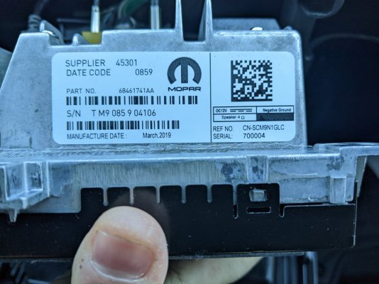

UAQ or UAS? What pn is your radio?
What "application version" is your radio on?
It appears to be a radio SW driver version with the USB Hub. a radio SW update appears to fix it. Panasonic radio SW goes by the"application version"
v39.6 is the latest, some have bricked their radios doing the updates... Not sure if they did something incorrectly.
InfoT should be able to give you a link to DL SW update for your radio
4C UAQ PN: 68461741AA
Media Hub PN: 5XG28DX9AD
That media hub part number should work with UAQ/UAS radios (made for Jeep vehicles but works). For the radio is that the part number that's on the back of the unit? I don't recognize that one and it's not coming up on any of the MOPAR sites.

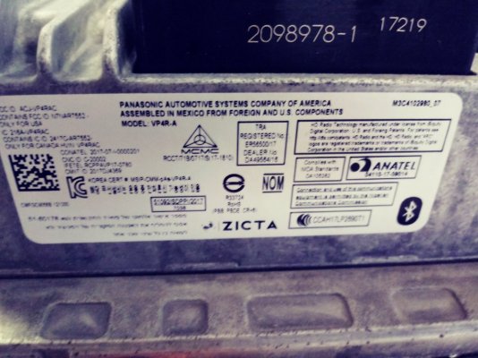

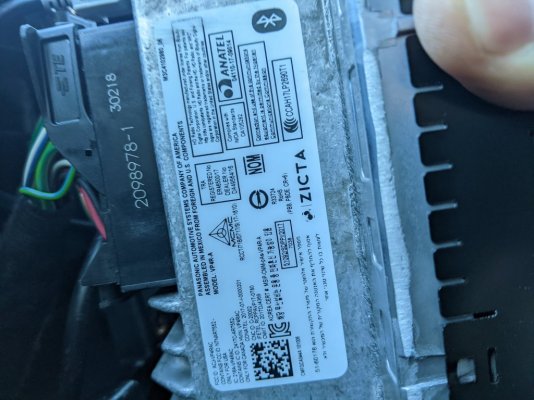

These are the only two stickers that are on the back

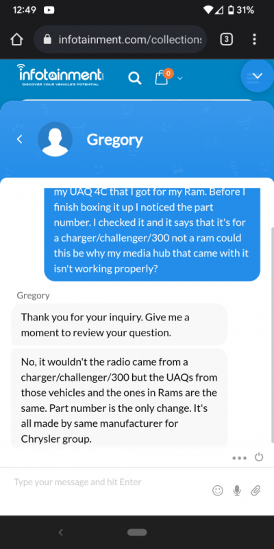

So messing around on the parts site I found this: https://parts.allmoparparts.com/oem-parts/mopar-multi-media-radio-68461741ag
I searched for the part number with only the first A and got a hit. As I understand those letters will tell you what version of that part they are on. AA would be the first version and then AB/AC/AD and so on. The MOPAR site is saying this radio is for Charge/Challenger/Chrysler 300 vehicles. Some folks on here have gotten MOPAR radios from Jeeps to work in Ram trucks but I think the sentiment around here is to stick with radios that are meant for Ram trucks. Infotainment might be trying to get away with sending you a radio that's not designed for Ram trucks and maybe that's why your having issues with the media hub's.
No idea if this is on the right path but something to inquire about with Infotainment.
To add on to this, here's some but notall verified 4th gen Ram 4c PNs so far ...
2018/19 classic 4th Gen Ram Radio: (USA) 68331631Ax (UAQ 4c Nav)
or 68331635Ax (UAS 4c non-nav)
2020 classic 4th Gen Ram Radio: (USA) 68461699AB (UAQ 4c Nav)
or 68461703AB (UAS 4c non-nav)
2018/19 classic 4th Gen Ram Radio: (Canadian)
68331632Ax (UCQ 4c Nav)
2019/2020 classic 4th Gen Ram Radio: (Canadian)
68340153Ax (UCS 4c non-nav) ---------------------
Based on the above PN sequence/prefix
I suspect that is a 2020 unit, from a challenger/charger, etc as Gordo mentioned... They would have had to change the case/mount so it would fit the ram b/c I believe the mounts are different.
* Not necessarily an issue as a few have done so without issue. Some PNs and SW seem to be compatible, but as stated, not recommended.
Also, based on your application version, you have Canadian SW and v29.x.x.
(Not sure where you're located)
Latest shipping version of Ram/Cherokee SW appears to be v39.6.x

Thanks for the help. @Gordo2212 @Mpgrimm2 This was their response and I'm in Massachusetts. They are going to exchange the Hub as a place to start.

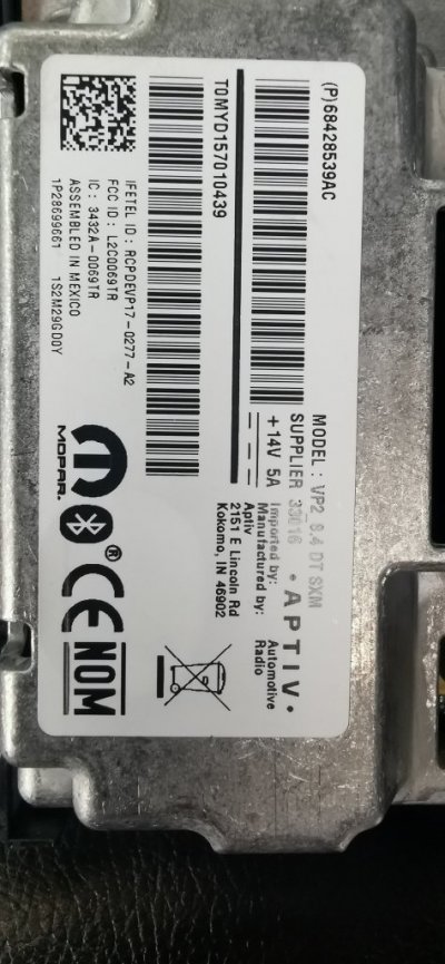

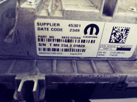

Hi Guys
I am Canada based and have been scanning through this post. I located a unit from the USA. I ran the vin which the dealer provided and the build sheet mentioned it had GPS. After installing the unit in my 2015 RAM 1500, I have a few issues. Backup camera says "camera unavailable not available" and no navigation icon? I have attached a pic of the unit. Is it really a GPS enabled UAQ 4C? How can I resolve my issues?

You're not going to have any luck with that 5th Gen Aptiv/Delphi radio. See a few posts up for 4th gen UAQ UAS and UCx PNs.

Like mp grim said no luck in a 4th gen with that radio.1 it's a 5th gen non nav.i think the nav have the screen seperate.this unit doesn't allow use of climate controls on the screen they are manual controls on the 5th gen with this radio.plus varied other issues.

Thanx for the reply guys. I actually purchased this unit and one with the screen seperate. Lools like I will be sending them back. I have found another screen for a 2018 truck. They are super hard to come by.
