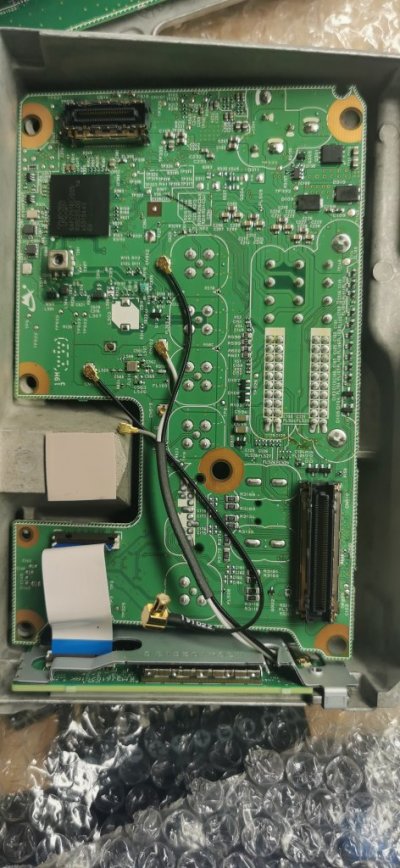

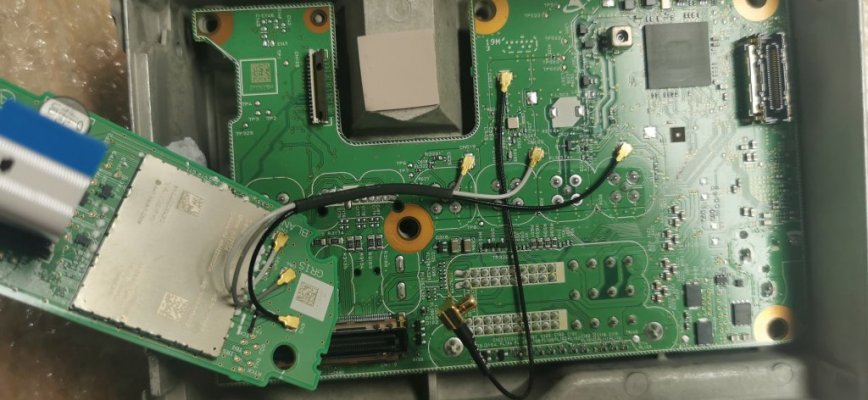

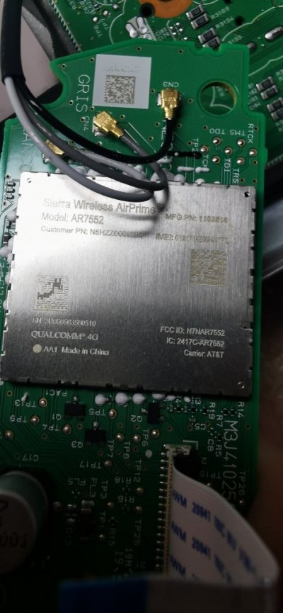

Firstly, thanx for the replies, I have found the issue with the GPS. I found a post on the Wrangler Forum. I simply transplanted the 4G modem from out of a new version UAQ where the module and screen are seperate units, 2021+ RAM, not sure on exact year model. Plugged everything back in and worked like a charm, GPS showed my location instantly.

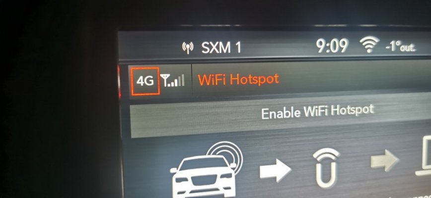

Looking back, I do remember seeing a few things which indicated that the module was not working.
1) I had no WIFI being broadcasted from the truck
2) No LTE or 4G being displayed in the upper left corner.
After the install, everything started showing as it should. I just need to replace the thermal paste. The 4G modem is located on the side of the back lid, held in with a metal plate. Need to be gentle as there are 3 wires, a ribbon cable and 2 additional pc boards - apologies for not taking better pics of the swop over.
From what I can gather, the 4G and GPS/SIRI antenna work together as a unit. It could also be that a connector came loose, so check those before replacing anything. I am neither sure if these modems can be purchased seperately or need programming, for me, it was plug and play. Hopefully this would help some others out there!

So I managed to activate the wifi function on the UCQ. Since it is a Canadian radio, I had to provide the VIN number from which the 4G board came and is not tied to my own vehicle vin or the radio. For those purchasing from someone like infotainment, this might be an issue if the radio parts were changed between various units. I assume that the actual chip is programmed to AT&T at the factory when the vehicle is built.
Wifi seems to be buggy on my current FW version where no signal is broadcasted until I change the wireless name.
