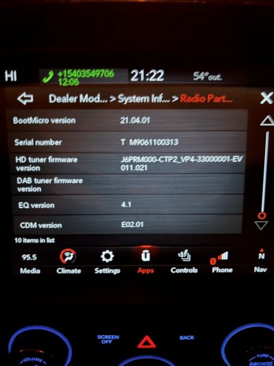

Based on what I have read, you hold the drivers side temp up/down plus defrost buttons all at the same time for like 10 seconds.
hmm.. that is what worked for me. I just tested again this morning and it worked
To Enter Dealer Mode
To find this, have the truck on or acc on, hold driver side temp up, driver side temp down, and front defrost buttons at the same time for 5-7 seconds and you’ll see the menu go to “dealer mode”
I still wonder if your radio is not fully sync'd/set up.

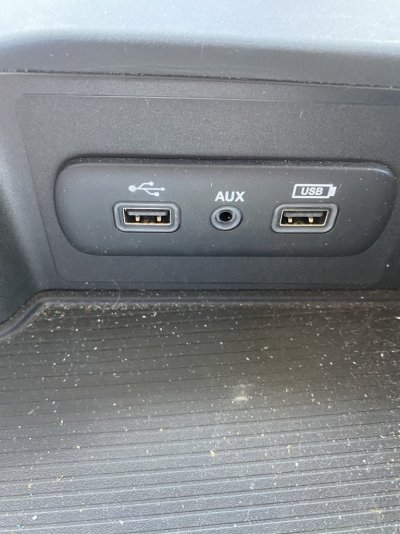

I bought this one, 68397098AE, off of eBay for about $40 along with the adapter harness from mpgrimm2. 3D printed the surrounding and it works like a champ. Plus I can use usb-c or regular usb.
How much would you charge to do it again and can you post a picture of it?
