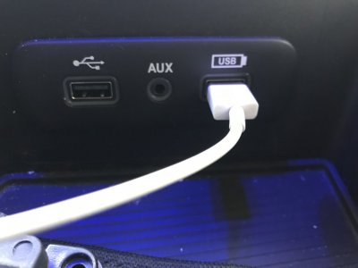

D9112958-834B-40E5-8D87-088638C18A97.jpeg Note on 2018 Ram media hub. I have a 2018 Ram 2500 that came with RA3. The media hub was not car play compatible. I’m not sure what the part number is as I haven’t swapped it yet. Notice the icons above the USB ports are different than the 68328704AC.
Just wanted to let you know in case you are looking in salvage yards.

Mike G will have to let us know.
I have the same hub but the side your cord is in is charge only. I will be doing the upgrade middle of next week and guess I will find out lol

Just went out and looked at my 2018 and you are absolutely correct, it has a USB icon. So in upgrading to a UAS / UAQ radio does that mean we have to switch to the
68328704AC hub? And is it going to be plug and play or will we need an adapter harness?
Yes, Mike G will know the answer to this one!

Like Paul said, the right side on that hub is charge/pwr only. You need to plug the phone into the one on the left.

So this does work except you only have one usb to the radio instead of two. I thought that would be correct cause it works in mine for media now. Don’t see why it would change.
