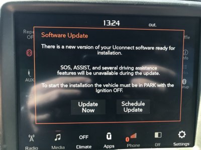

Also, here is a screen shot of the OTA update.

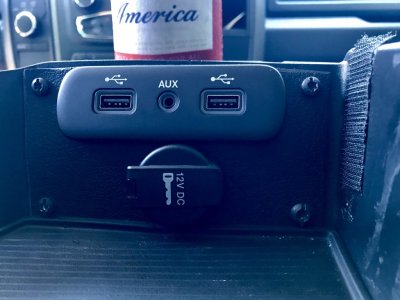

Thanks. I ended up taking an old phone and leaving it connected in the center console. Now I use waze from that while my phone is playing pandora and viewing my gauges. It works better than I thought.
