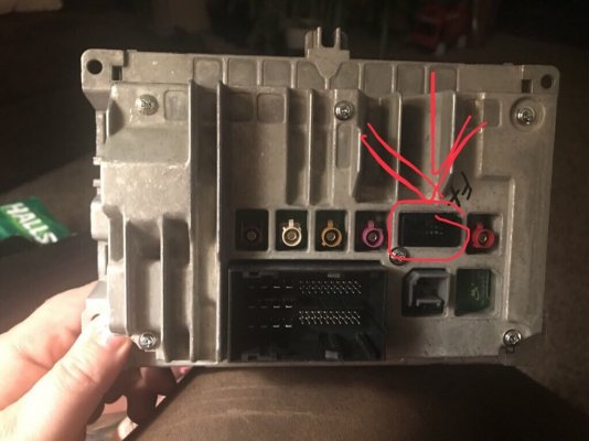

This might sound dumb but is the black plastic connector(smaller one) on the back of the UAQ used. Does anyone know what it is specifically for?

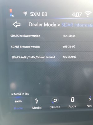

2 questions for you...
What is the actual PN of your UAx radio?
What is the application version of it from within dealer mode (this the "fw" version people need to refer to with the Panasonic radio s as refrenced by the Tsb's).
Note: there were Model Year 17.5 UAx radios in Cherokees, challengers & some other FCA brands but not Rams. Early testing with these radios was problematic, especially on pre v18.x App. Versions.

Stealing your picture to ask another question. Anyone know if you can order those colored clips? My radio was missing the mustard yellow one, so my plug doesn’t fit snugly. Also can anyone tell me what they all go to?
Thanks

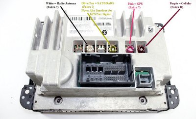

What all gets connected on a laramie? I don’t have my 911 bypass connector hooked up and haven’t had any issues.
Are the pink and olive the same?

OK so here's my question for today. I upgraded from a RA nothing to a RA2 added a microphone, complete steering wheel controls and wired the rear camera input. right now I'm missing the compass feature but as soon as Deereguy makes me a harness I'll have homelink and a compass.
I only have white (antenna) and yellow (sat) Fakra factory connectors in my factory harness.
I would assume no purple (cellular)= no 911 and I don't care, but if I have no purple (GPS) what will give a signal to the NAV function of a UAQ? Am I missing the idea? Do I need to add something else or will the in a NAV UQ not ever work for me?
Seems the yellow also functions as gps. At least that’s what the pic above states
